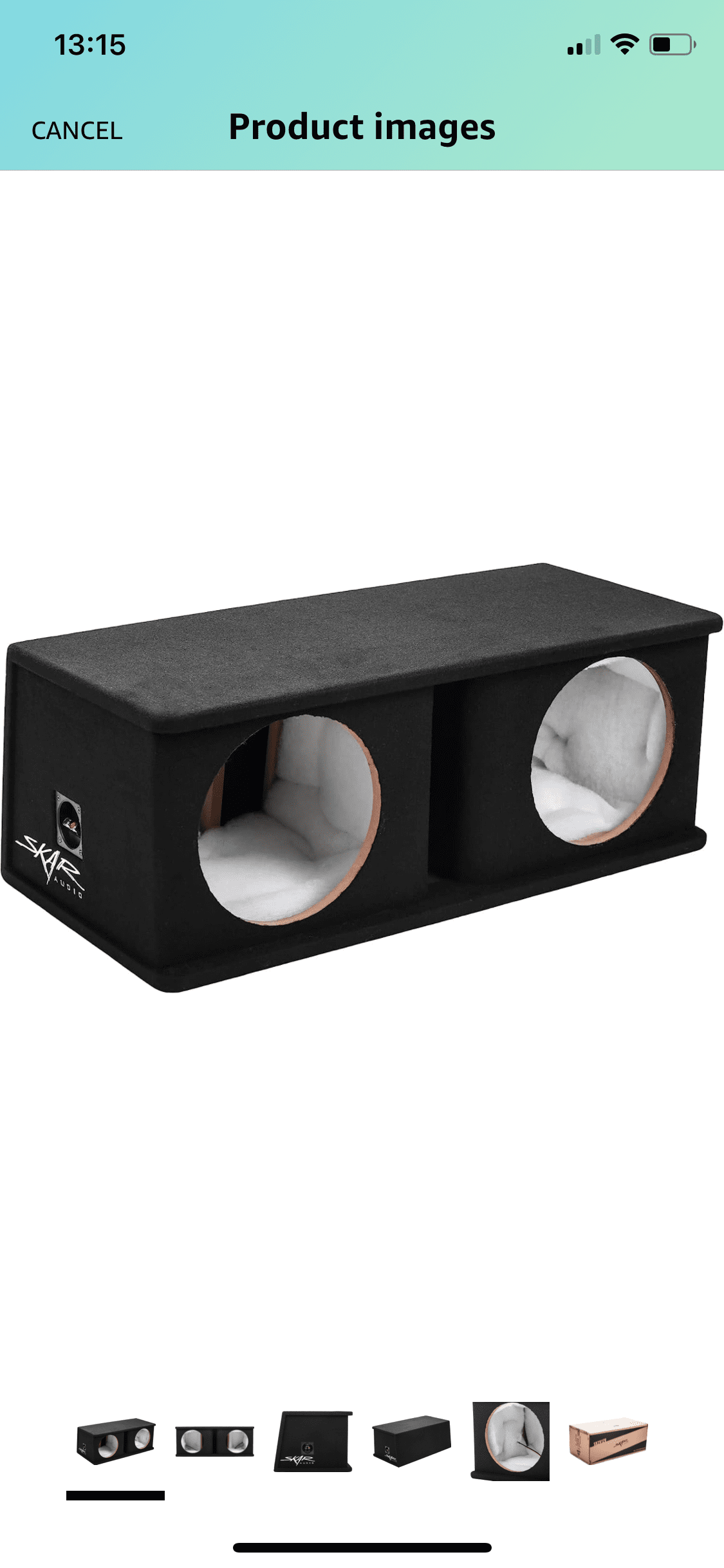

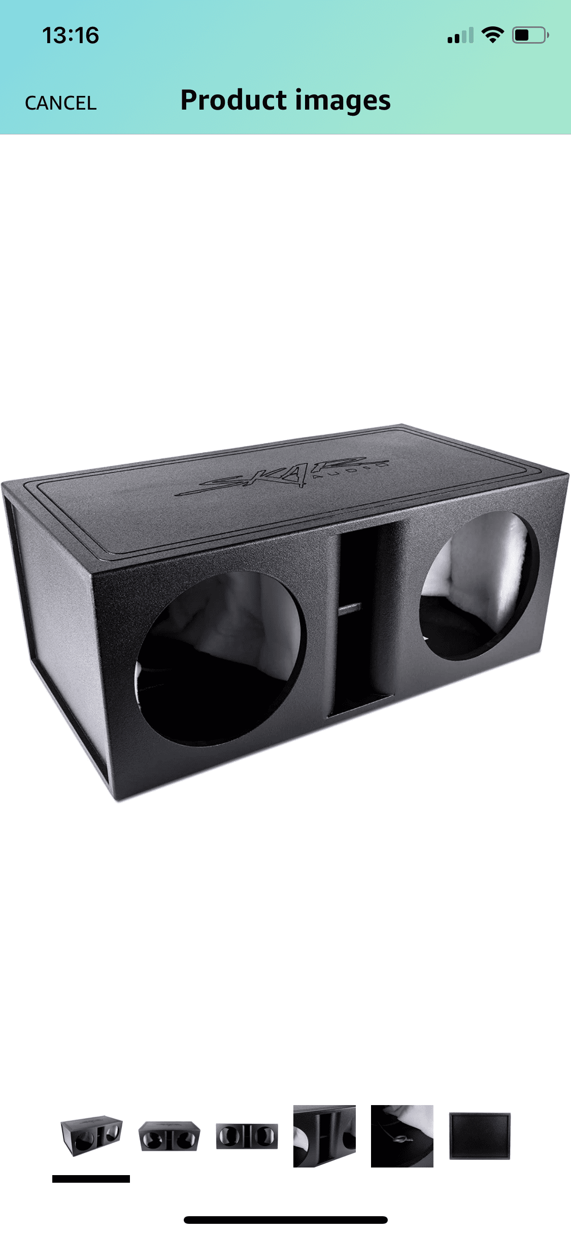

Currently I have a bbox that’s alright but I know my subs(SDR’s) can hit harder than they are. Could anyone tell me if either of these enclosures are worth it? First is $212 and carpeted one is $160. Or does anyone have any other recommendations?

I would like the size to be pretty much like those Skar box’s attached. Only because any bigger probably wouldn’t fit in my truck. The height really doesn’t matter tho.
Skar's boxes are not known for quality and many have had them just fall apart after a couple months. Plus the tuning isn't right either.
Best bet is to either build a box yourself with a someone doing you a box design or contact GP as stated above and they can do a design in a glue it and screw it setup where you just have to put it together and then carpet it or stain or paint it.

Vented enclosure: 4.25 ft^3 tuned to 22 Hz. >20 in^2 of port surface area per driver.

If you were local I’d build you a box for 200$. it seems like a ton of people have the Skar SDR. It’s the sub I’ve done boxes for most this year. I’ve seen a few of those skar boxes fall apart. They’ll work ok for the SDR, but I’ve had 2 builds for the Skar evl subs in the last month and both of them had blown panels on the Skar box. If you go with a prefab, get the largest box you can get and set a subsonic filter. The port tuning on those prefab boxes is higher than they advertise. If you’re planning on listening to rebased music or playing low test tones in a prefab box, you’ll blow those SDR subs. Playing under the box port tuning will kill subs.
