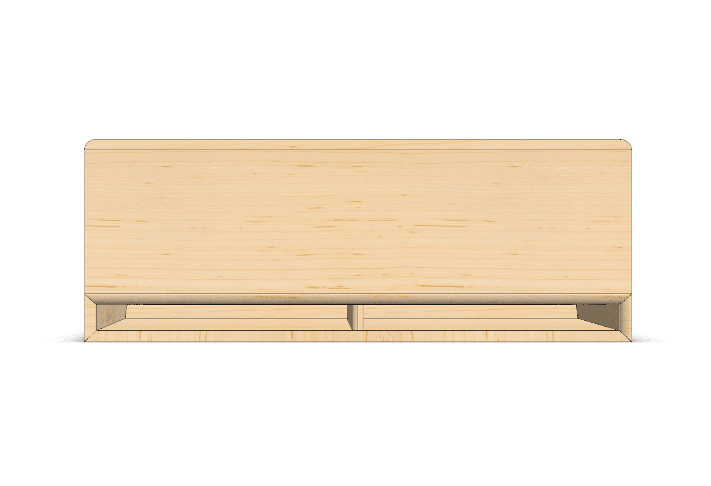

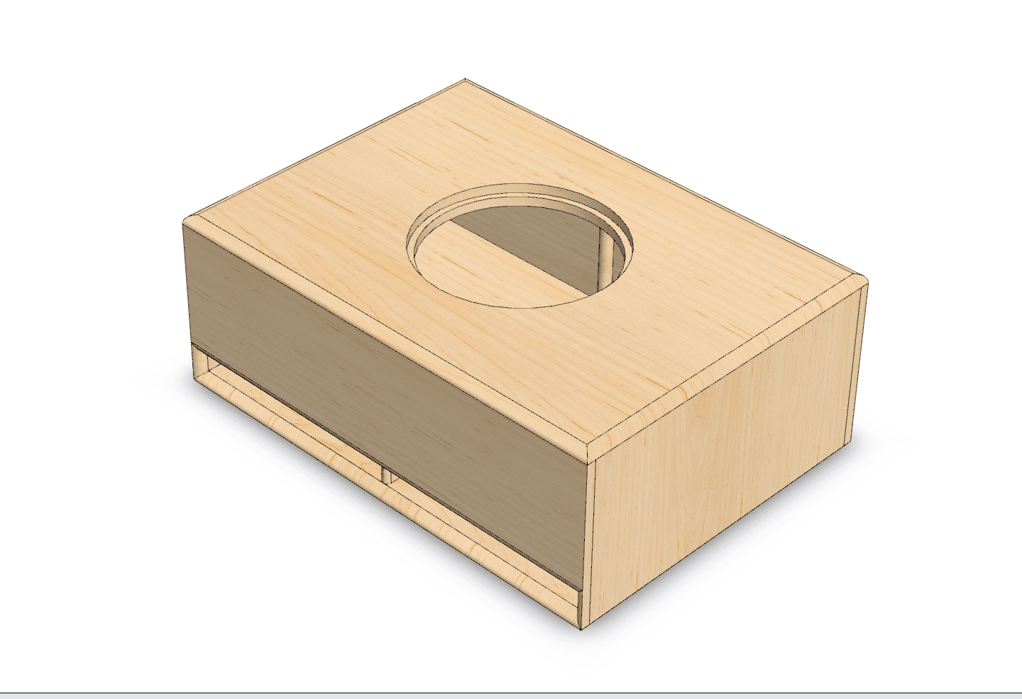

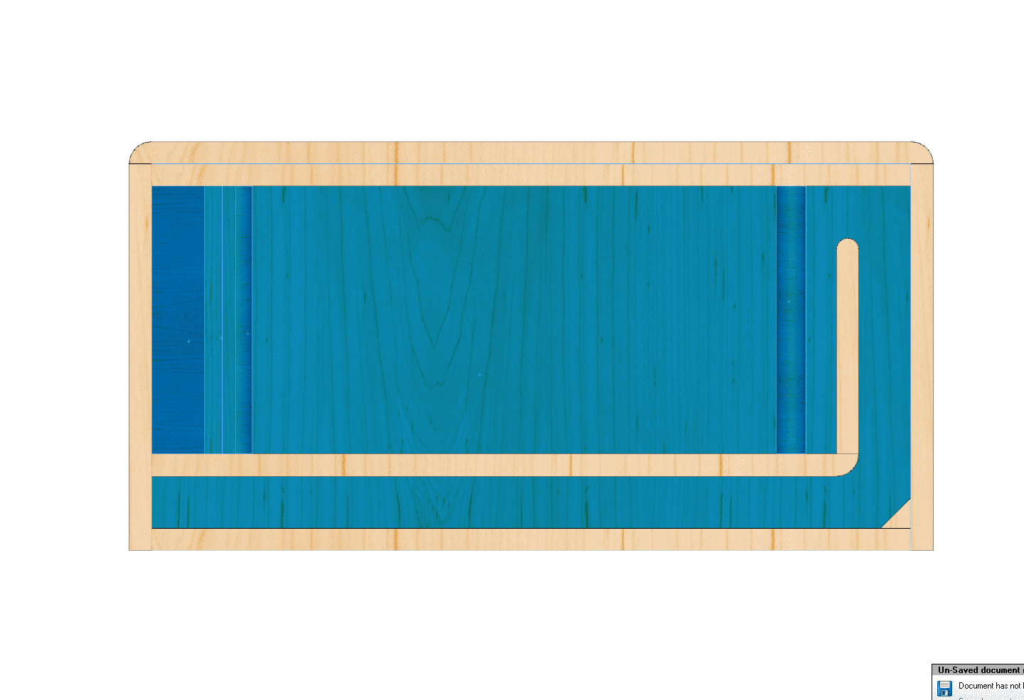

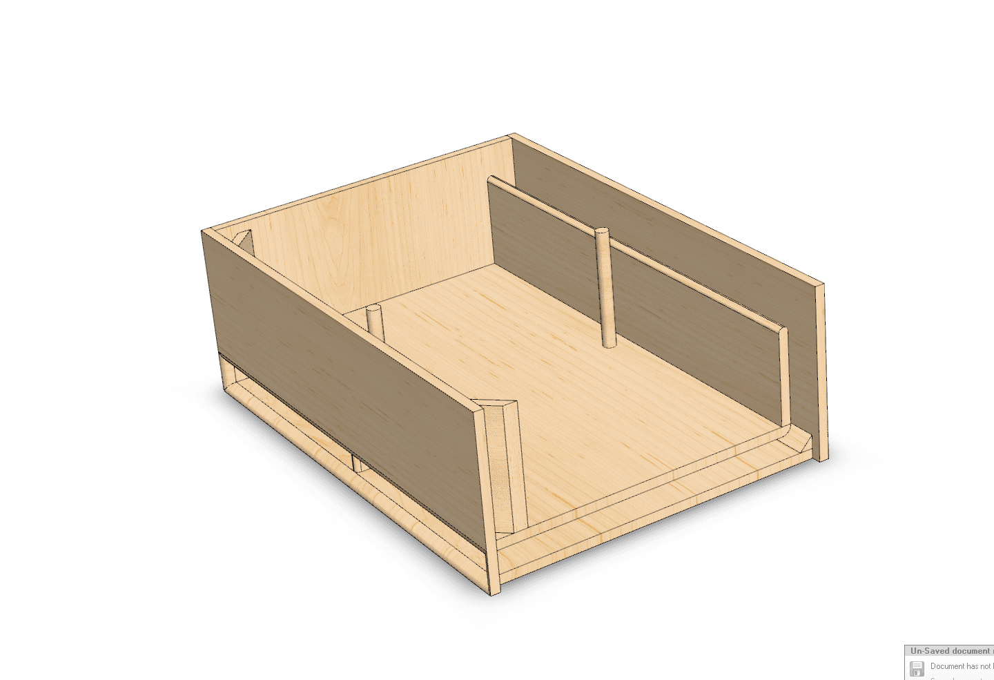

Box for a single 15
T.I.K.
F*ck it, we'll do it live
4.75ft^3 gross volume
4ft^3 after displacement
Port is 35.5x1.75x38
Tuned to ~ 31hz
4.75ft^3 gross volume4ft^3 after displacement
Tuned to ~ 31hz
The port displacement alone is 1.95ft^3, assuming the 35.5"x1.75" is the opening size and that the port goes an actual 38" inside the box. You'll have 35.5"x2.5"x38" as your displacement, which is 1.95ft^3. I'm just curious how you came up with just .75ft^3 worth of displacements.
Box dims are 37x27x13, I'm not stupid
just mistyped the main post
