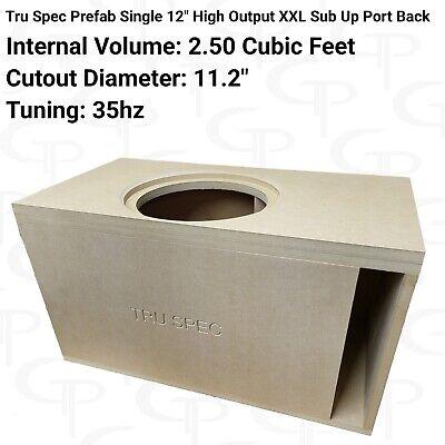

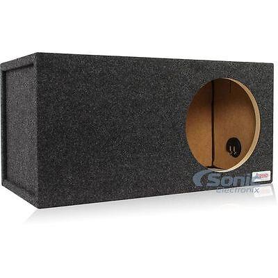

Here are a few contenders:

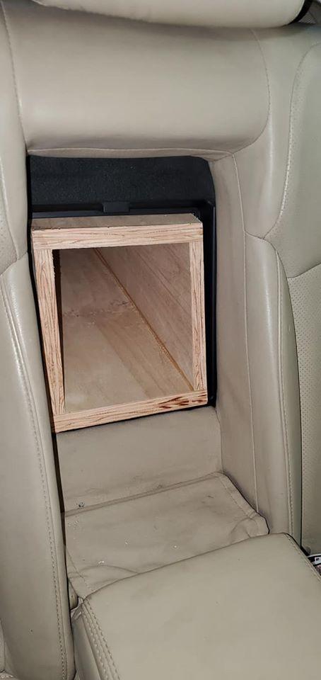

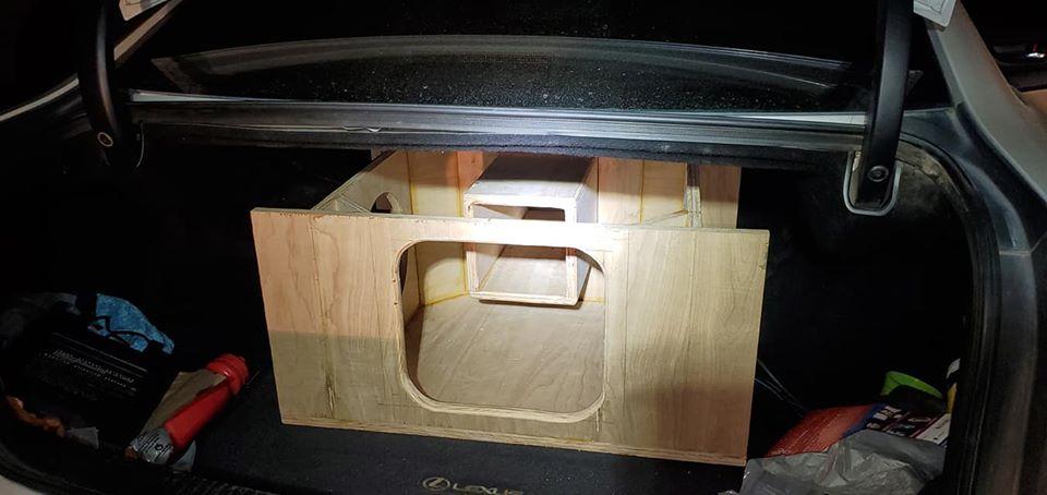

If it was my car using a single 12 I'd use that ski-pass and do a 4th order. The loss of cone won't be as noticeable and it will be punchy with a sealed type low end extension. Plus output will be directed into the cabin for added output.
Tuning a 4th around 45-47hz should give you what you're after imo.
This ^^^^ was designed for less than optimal subs (DDX-10's) and the results floored the customer. Clean bass with a punchy response and good low end extension into the mid-upper 20's.
