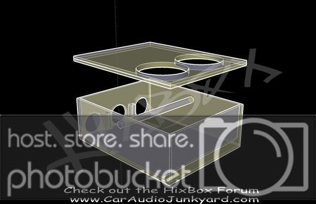

I took Ion's advice and actually designed the box before I even opened SketchUp. I used SketchUp this time simply because if it is correct, it will help me by providing a bluepring when I build it since it will be the first box I have built. It should be 2CuFt at 32Hz. I don't know alot about the ports and sometimes using WinISD it will give me a length that is longer than the dimension I want to use it with. Is that when you go around the corner with it? Anyways, here is the one I just did that I hope is correct.
Thanks for the help so far. I'm tryin to get the hang of it.
