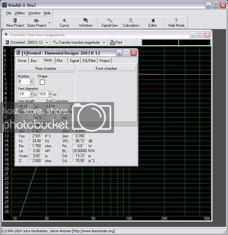

i have decided to not put the box in my back seat instead i put it in the hatch of my 94 formula. the problem is the box ed has designed will not with in the trunk.
in my trunk i have 24*12*18 to play with, i have more but in order to try to save some work ill make it a rectangle and just fit it in the well of my trunk. the sub i have picked is a Elemental Designs 13Ov.2 Subwoofer. i will make it out of 3/4 inch mdf. here is the specs page of the sub and the suggested box designs http://www.edesignaudio.com/edv2/pro...products_id=35
i would like it to be a ported box at 30 hz as per their suggestion.
can any one help me?
thanks for the help
i just dont under stand how to do it in win isd. dont get what volume i use(with or with out port volume taken out) if i use the volume without the port vol taken out(with the sub vol taken out) i get a 49.29 long port (how the h3ll do i do that?).
i used the tutorial at the top and i got a box of 14.5*25.44*11 and a port length of 41.93. that is the exact. can i round to a less exact number?
and how do i make the port length 41.93?
can someone check me on this?
thanks for looking i talked with ngsm13 and he says i should use a full length 4" aeroport and make my box 14.5x30x11 and that will tune me to about 30.3 Hz(close enough i wont notice).
