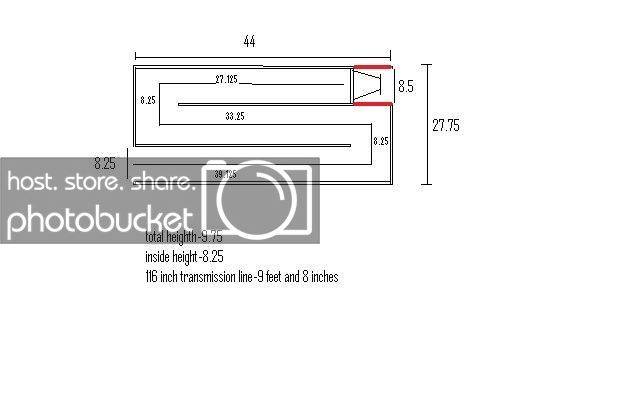

for an 8 inch sub. haven't decided on the sub yet. opinions? too long? the red is 1/2 inch instead of 3/4.
i might do that.
without them, you have significantly varying line areas which usually has adverse effects, such as killing output
and when you add them, you definitely need to recalculate the length because you'll lose a few inches or more in each of the corners
don't i calculate down the middle? i planned on putting in 45 degree wedges in the corners, but didn't know they shorten the actual length.
I'm not sure about this design. I mean do it, and let us know how it sounds, but the t-lines that I've been playing around with (granted I just started ~8 months ago, and have only built a handfull of them) have always had a loading chamber, a compression chamber, an expansion chamber, and an acceleration chamber. T-lines can be picky, but when built properly they will slam. I'm interested to see how this turns out. I'm still in the begining stages of learning about t-lines, so any info on how this box performs is appreciated.
i don't even have as much experience as you. never done a t-line before. it's perfect for a false floor design in my s10. less than 10 inches high, spanning the entire floor surface of my extended cab.
