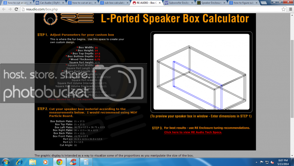

K kingjd7 10+ year member Senior VIP Member 253 0 Kent Ohio May 13, 2014 #1 How does this look for 3 Skar IVX 12"? The tuned FQ should be 35 how do I raise it? Click to read more...
adulbrich 5,000+ posts Olive oil un-virginer 14,433 162 Ames, Iowa May 13, 2014 #2 Make your port wider. You could also shorten the length of the port or make your box smaller. There are lots of things you can do to raise the tuned frequency
bubbagumper6 5,000+ posts CarAudio.com Veteran 11,443 351 The D May 13, 2014 #3 Make the port shorter or decrease the overall volume. Not sure I'd use that calculator though, it's notoriously inaccurate. I usually use WinISD.
