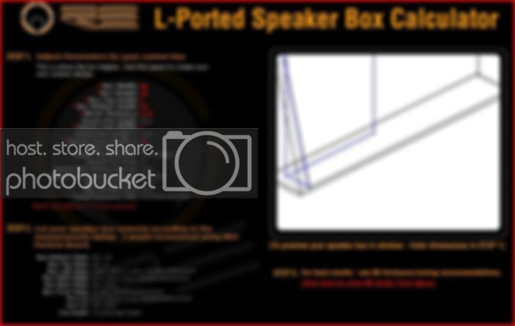

So this is what i have planned so far:
Any input?
