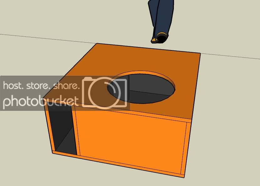

i will build it.. i just dont know how to figure out the what the port length should be.. i want a pretty wide port. my box right now has a 5" wide port =] .
you don't want to go to wide
to much port area can also be bad
so if a 5" wide by w/e port equals 25 in^2 of port area per ft^3 it may not work well this is why port tunning is so imPORTant /rule of thumb for slots is 12-16 in^2 per ft^3 of net volume
that being said I've gone both bigger and smaller with good results and with not so good results
it all depends on set up box/subs/vehicle/imp rise/voltage/etc......

wow how long is that thing 30+ inches??and it's not too oversized it's only 17 in^2 per cube so you good there
i dont remember for sure but i think the box is 30" x 30" x 14"
port is 29 1/4" long
heres a pic of the box

and to explain the 45 degree in the corner of the port.... it is so the corner of the port will have continuous width and not get larger then smaller again like in a corner ....
