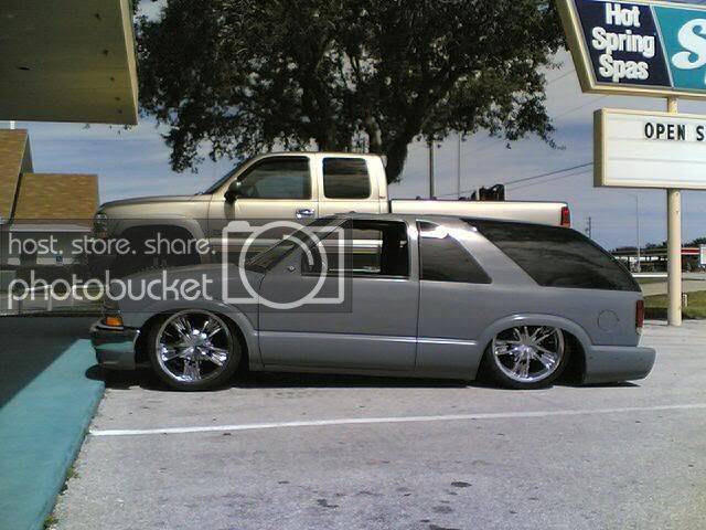

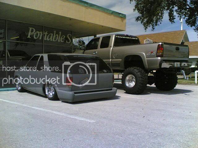

Car in case anyone was curious:

Nice truck man. Looks real clean. I actually have that whole xtreme kit , a RAW rollpan, and an Envoy front end just waiting for it to get painted. But props on your truck.

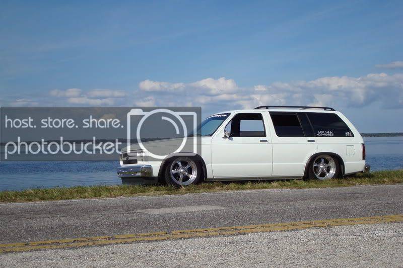

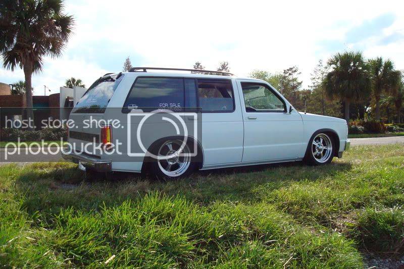

Here are (were) mine
So now on to your box. If you could add 1"-2" (20"-21") to the height of the box, you'd be golden. Then you'd have the 2cubes per that you'd need. //content.invisioncic.com/y282845/emoticons/cool.gif.3bcaf8f141236c00f8044d07150e34f7.gif
Also, my best results were subs up, port back or Subs up and port to the pass side.
