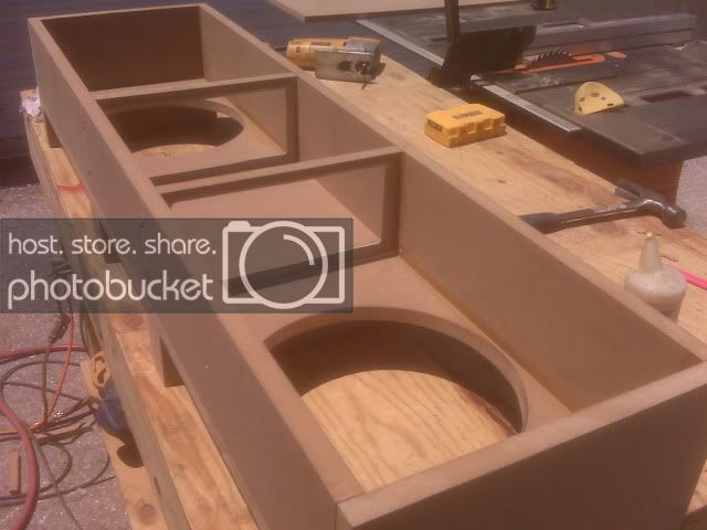

this was a down facing i did 4 a 2007 expidition (top is off ) it was for two flat piston subs and was only 1.65 ft^3 you could do some thing like that and still have a bit of cargo space (stealthy )

So this box was sealed or ported? I am assuming sealed. For the present, I have built a downfriing sealed 1 ft^3 box but would really rather have a ported box. I have looked at that box on ebay over and over. I would have done something like that if I had 2 subs. It seemed like a waste to buy now and have one side empty. I have been seraching for a box similiar with 2 ft^3 for a single 12. Everything I have found is either ridiculiously priced or a cube that wouldn't work.
