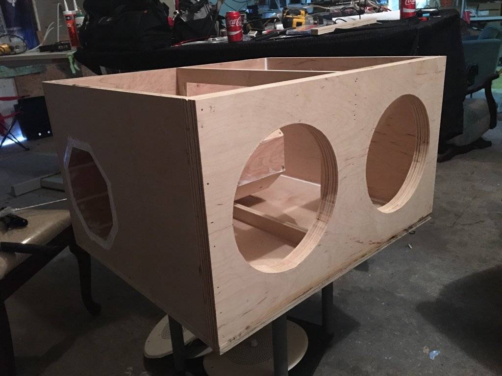

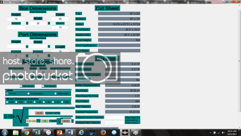

I would put one on each side and angle them out a bit, and have the port coming out of the middle. Heres a quick picture and stat sheet of what i'm talking about. I included bracing displacement for doubling up the baffle, the front, and the sides.

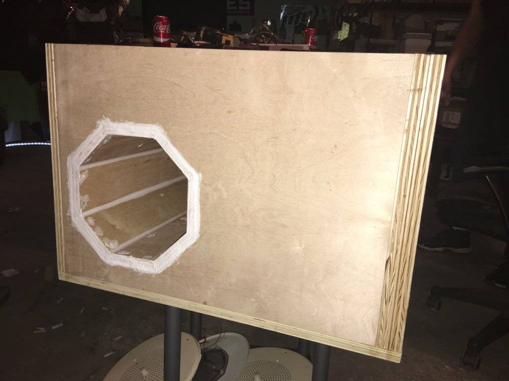

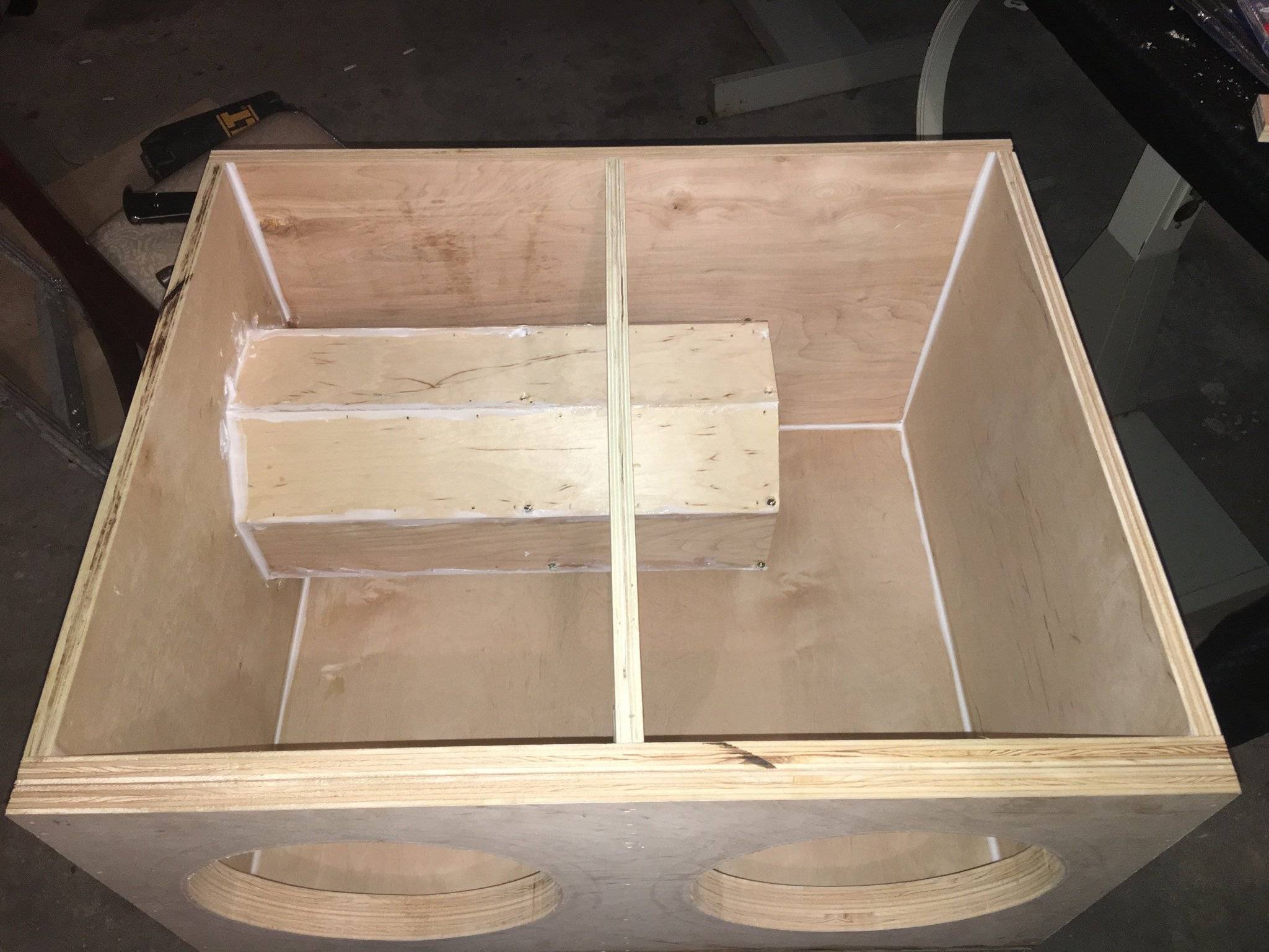

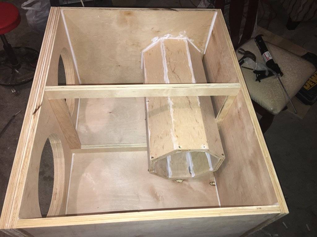

Thanks for the suggestion. I like the angled design. I was thinking would a bandpass be better firing forward as all the panels underneath are thin aluminum?? Thanks guys
Side firing slot port will work much better loading off a side wall under there.
