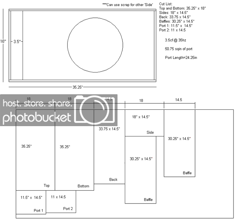

well i decided while im waiting for the sub to be built and shipped out that id whip up a quick design...box will be double baffle, braced side to side and top to bottom with 2x2 and resined. whatya think?
Only 2500? //content.invisioncic.com/y282845/emoticons/naughty.gif.94359f346c0f1259df8038d60b41863e.gif
lol yeah...anymore than that and id DEFINITELY fry my stock alt...lol. even 2500 is pushing it considering the 10 year old one that came from the factory fried when i had my bx2005d lol
105amps
it should be good if i can get a battery in there. when i had my bx2005d, i just had a 30 dollar wally world battery lol. i plan on getting either an odyssey 1700 or 2150 from batteries r us here in edgar...//content.invisioncic.com/y282845/emoticons/naughty.gif.94359f346c0f1259df8038d60b41863e.gif
