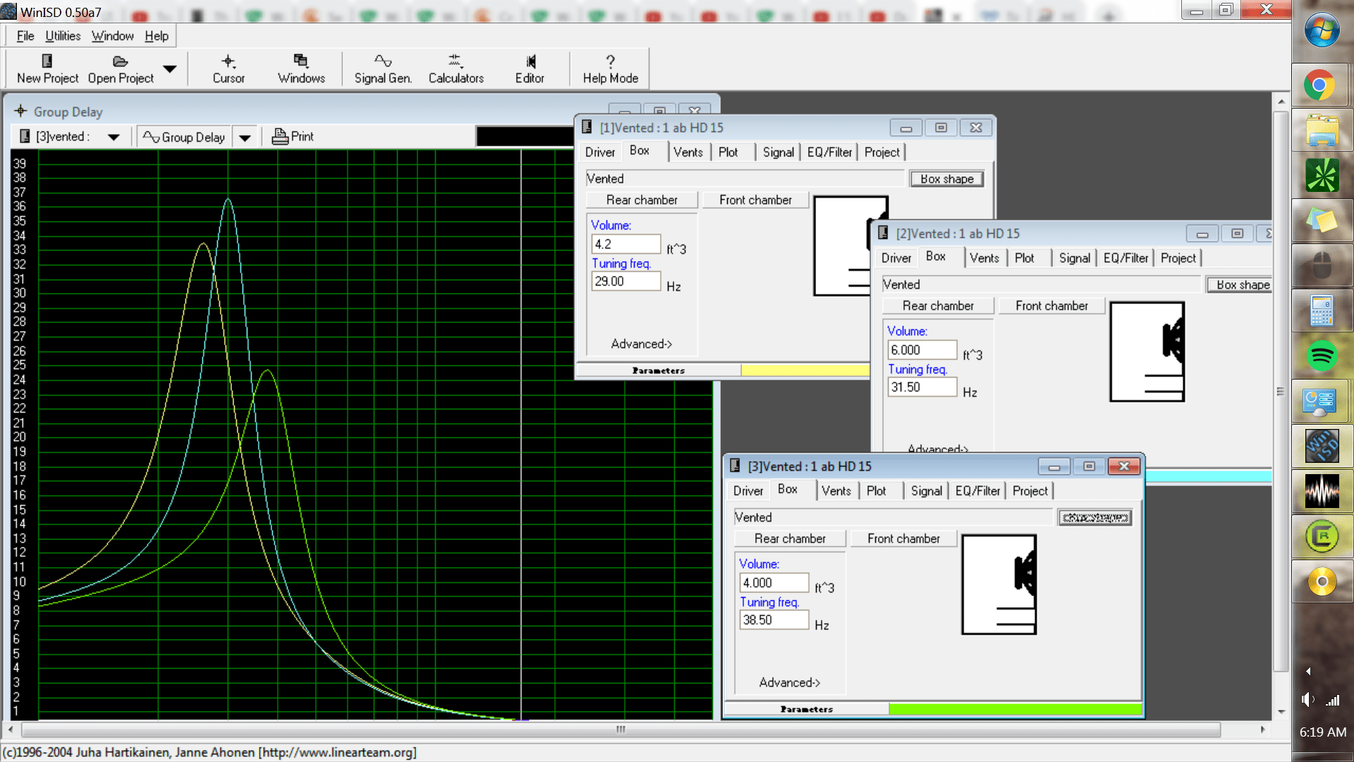

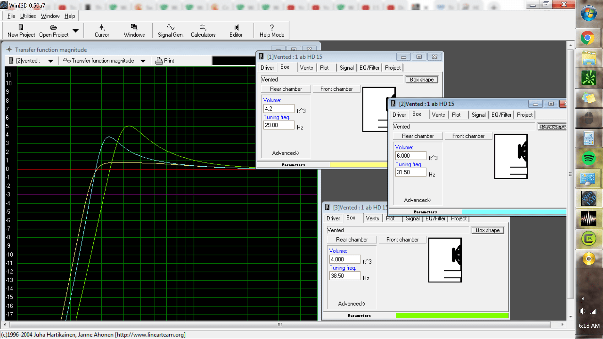

frequency response of each flatter lets you play more evenly, peaks mean bigger emphasis in certain ranges.

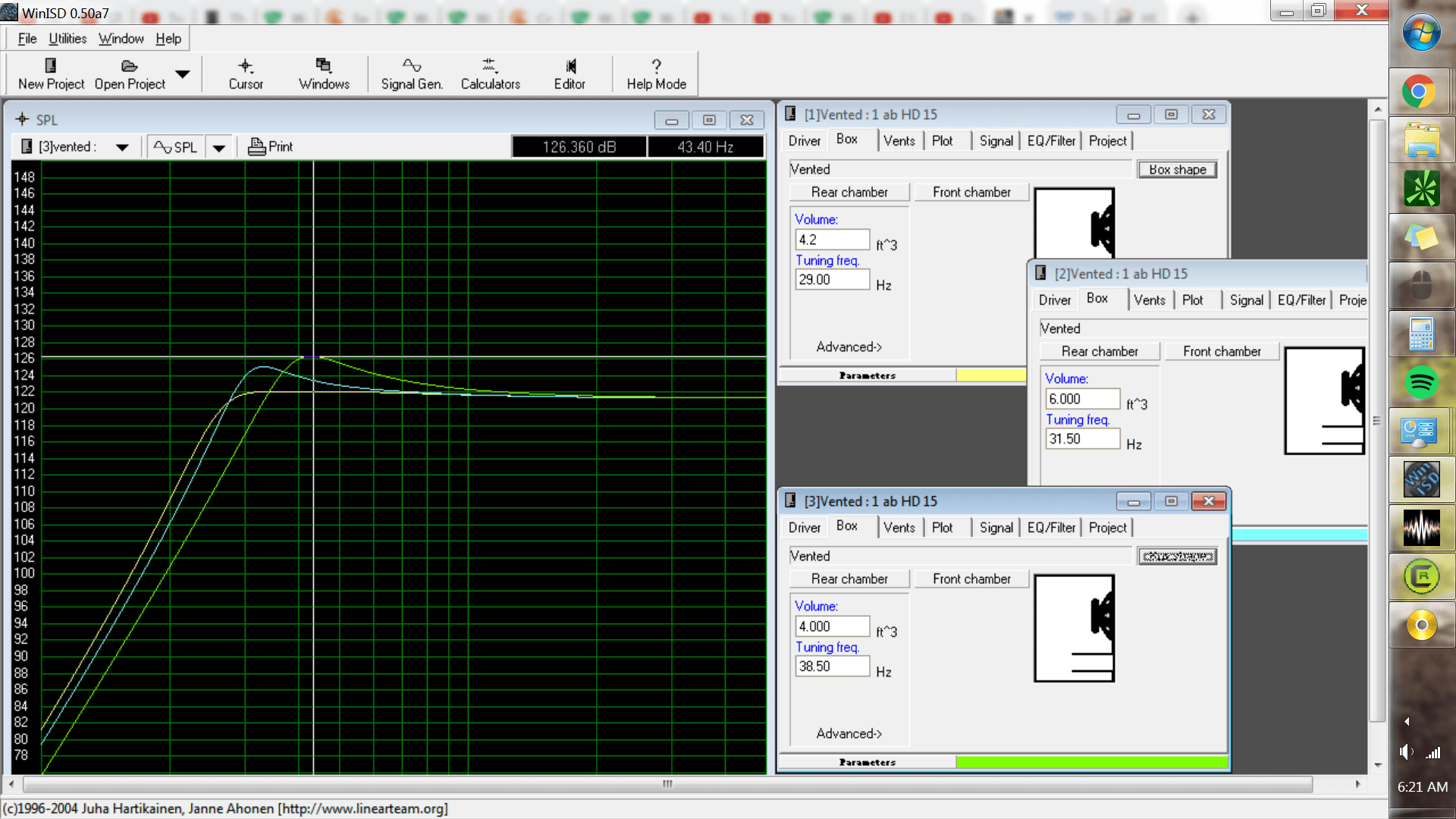

potential SPL performance without accounting in cabin gain. You definitely want to account for your car's resonant frequency which can easily make any of these boxes overly peaky.

This is the musical accuracy aka group delay, lower is better.

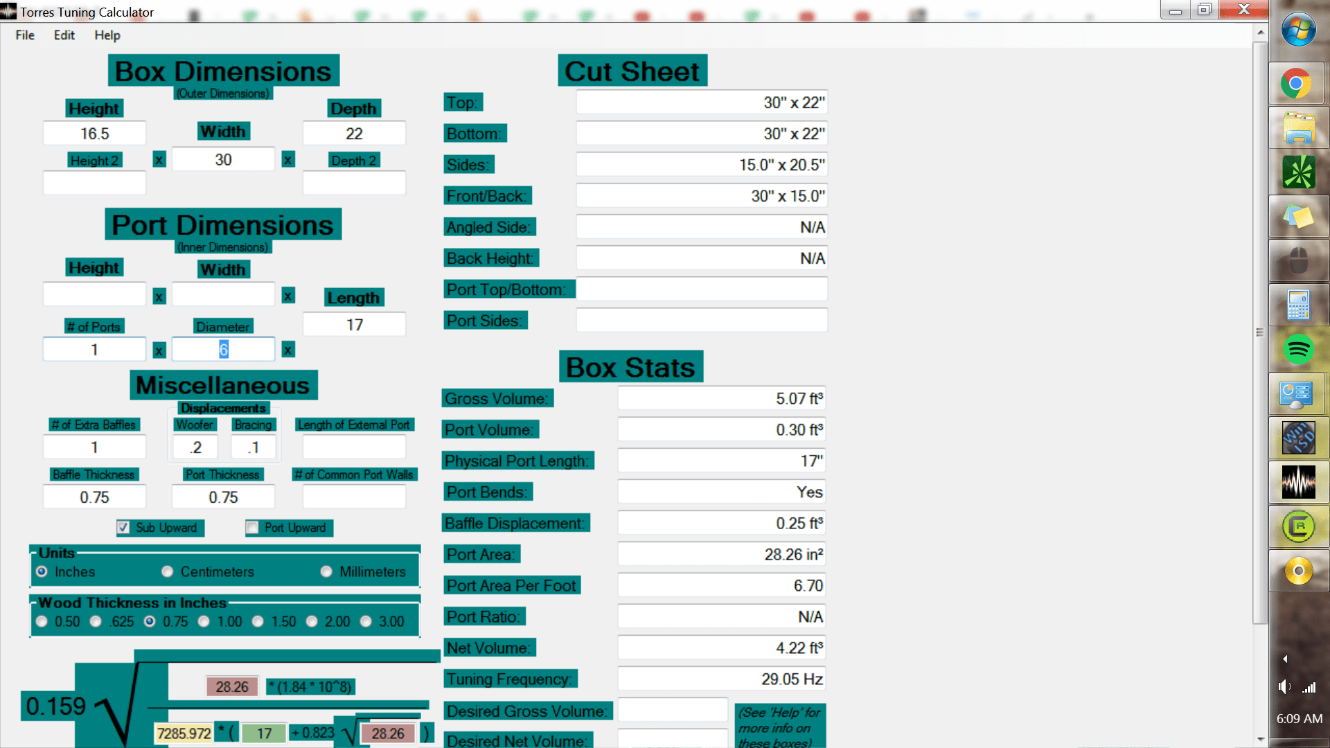

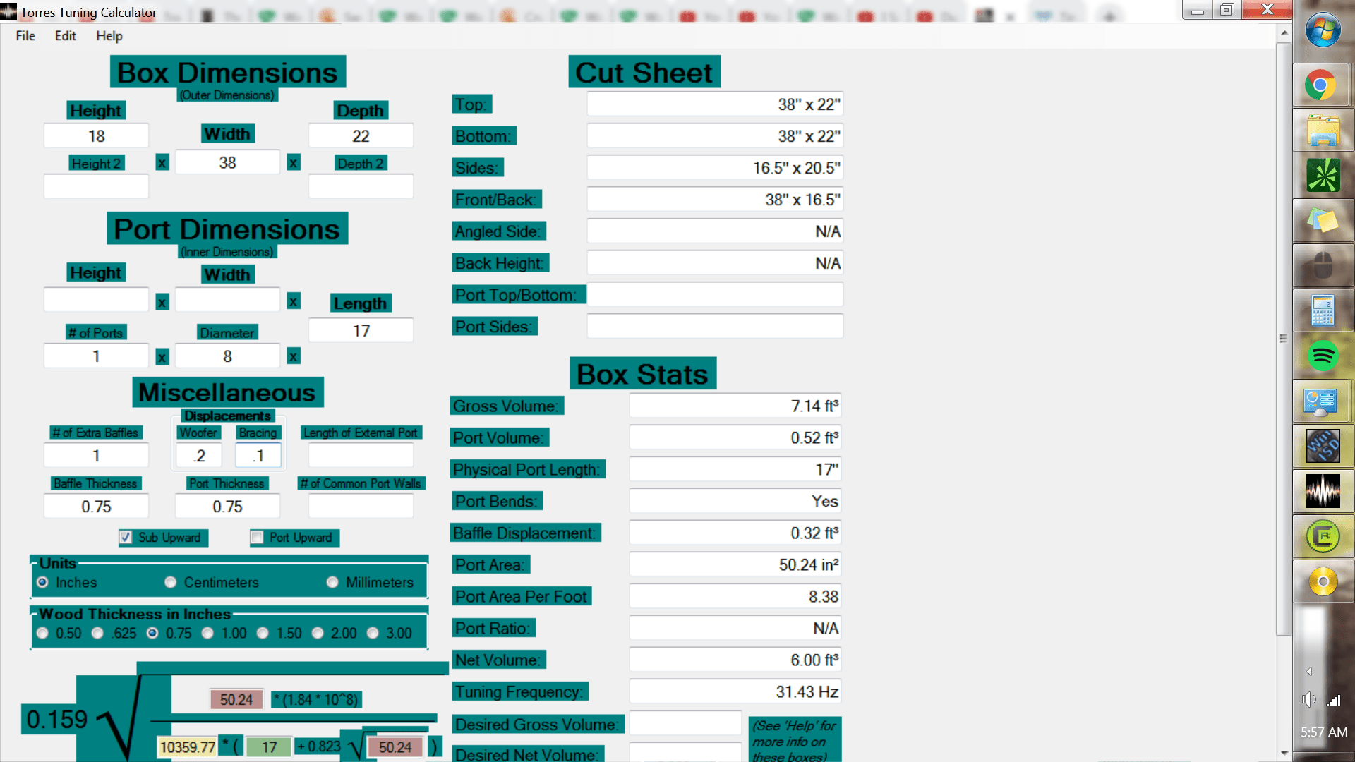

I did make a box for that sub but I need more trunk space now. There is a lot of space not being utilized by not going to the backseat contour. I did a quick box build ap and it’s showing me to build the attached photos. My question is would anything frequency wise change if the port opening is moved to the flat side because I don’t want a port shooting towards the backseat but rather towards the rear end of the car and the sub mounted there as well?
