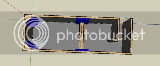

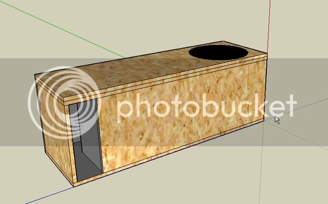

thanks for all the input guys but i got a design that works nicely with my space , i think it will be plenty strong //content.invisioncic.com/y282845/emoticons/smile.gif.1ebc41e1811405b213edfc4622c41e27.gif its 4.5ft^3 tuned to 40hz with 16in^2 for every 1ft^3 , just like dj and all the guys at DD tell me and everyone else //content.invisioncic.com/y282845/emoticons/yumyum.gif.0556df42231b304b9c995aefd13928a8.gif double baffled it only sits at 17" high ....... and i did have to make it 16" deep to fit the sub and even then itll be a tight fit , but because its double baffle im not worried about it ..... building starts in the next couple days......

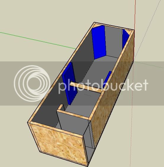

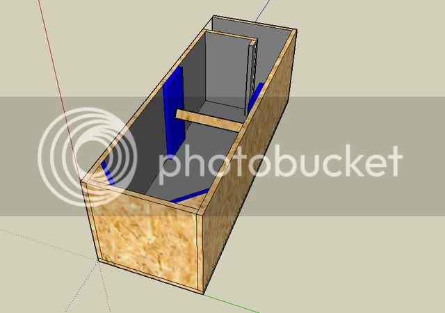

hmm what iff i replaced the dowel and the support pads with window braces.... would it be stronger ?? //content.invisioncic.com/y282845/emoticons/rolleyes.gif.c1fef805e9d1464d377451cd5bc18bfb.gif
Window brace will be stronger as it ties all the sides together. I'd use 2 of them, roughly dividing the box into 3rd's if you can without interferring with the sub. Also add a 45 in the port corner.
