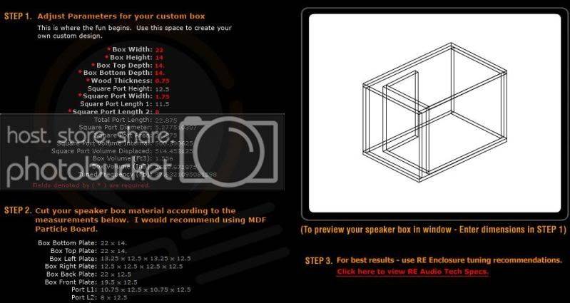

A single Pioneer Premier TS-W3001D4 is going into it. They spec 1.5 cu for a ported enclosure. So does everything look right on there? any ideas to improve it while keeping the dimensions even, the tuning from 32-38 hz, and the volume to 1.5 ^3ft
aslo, why like on the left panel, are there 4 dimensions? is it going to be 2 pieces on top of each other? thanks in advance for the help?
no its be cause the re calc give you the option to do a wedge box thats why it asks top width and bottom width if you had made those different the 2nd set of dims on the side panels would be different
Yep. that tuning should be good for rock, you could even go with 40 but I am not sure if that sub will do well below tuning at all so I would stick with what the manufacturer recommends..
