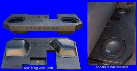

It will have to be under the back seat(s). These truck have stupid molded cargo areas so a rectangular box can't be used. So it would need to be something like this picture, except for a single 8" Skar ZVX8.

I've seen this Foxbox in person and the supposed cu ft for them isn't true. I went to a buddy's house and he was doing exactly what you're wanting to do. I'm curious as to how your gonna modify an already prefab enclosure?
The wood portion I could build entirely on my own if I had their molded bottom part and knew what dimensions to do the wood. I have all the tools and skills needed to do the labor, just no idea how to do the design. Modding a prefab box wouldn't be ideal, but may be doable.
On their site, their single vented box is stated at 1.85ft^3. So even if that were slightly overstated, it is more than the suggested 1.25ft^3 Skar calls for this sub. And if I wanted to use two of them since I have them, the dual vented box is stated as 1.55ft^3 on each side. So that might actually be close to what I would need.

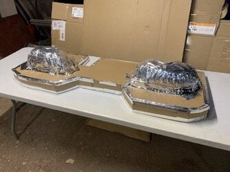

Alright I was able to pick up some mattress boxes this weekend. I'll tear things apart in the next day or two, build a mock up as best as I can, and see what to do. Still haven't heard anything back from Fox

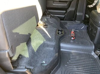

I've got the same truck, well, it's a '14 but the stupid molded cubby holes in the back are the same. When you go to spec out the space with cardboard, pull out the carpet under the seat and in that cargo area. The carpet has padding underneath and you will gain some space by removing it.

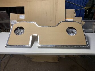

I didn't pull carpet or lift the seats to make the mock up box, so I guess I'll add a small factor in if my mock up happens to be close to adequate.

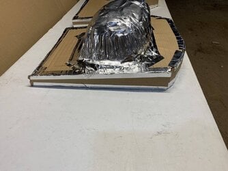

Frankly, even just building the mock up for this thing today was stupid. From start to finish, I spent almost 4 hours, and I still haven't calculated the air space because I can't find any filler to check it with. I can say, that without a doubt, I'd rather buy a box than build one for such a ridiculous space. But, since I wasted the whole afternoon on this dumb mock up box, I'll see what I can find to work as a filler to check volume.
Anyway, the box is small. Just by looking at it, I'm thinking there is no way I get close to 3ft^3. As it is, the box touches the bottom of the seats. I think I can lift the seats up to 1.5", but still need to factor in mounting and excursion of the subs themselves.
