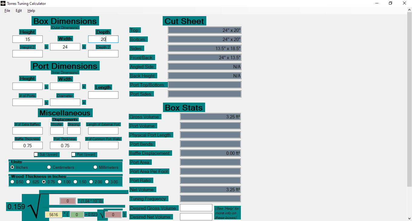

My first thoughts on the box 24 L x 20 W x 15 H which gives me a little bit over 4cuft3.
Just for kicks I ran those numbers in Torres and will ask you this... where did you come up with 4ft3 net?
It seemed awfully small for 3 10s to me.
Once the subs, port and any other displacements are taken out it's going to be AWFULLY small.
I'm thinking you must have mistyped the sizing.

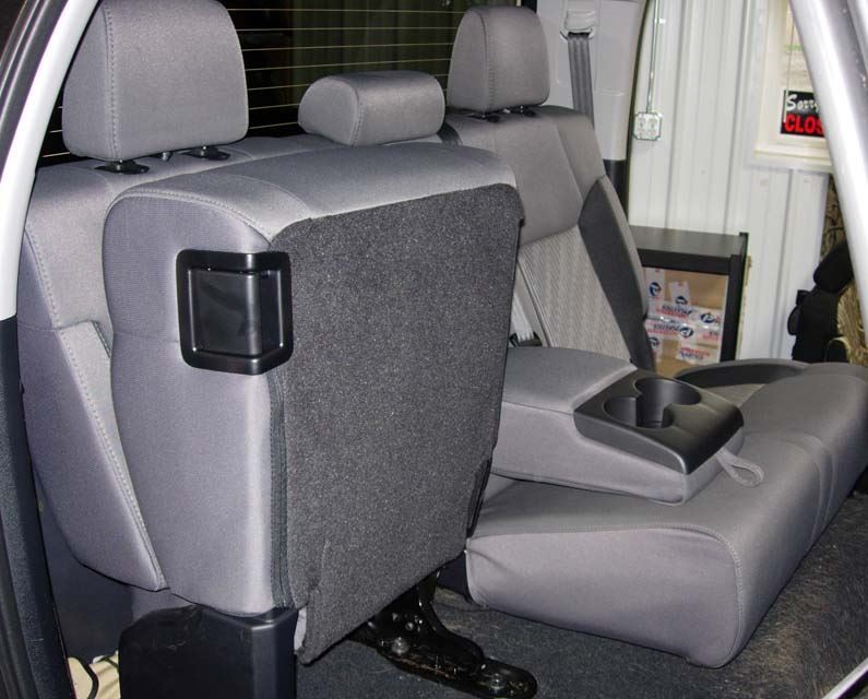

I used a cubic feet calculator from google, I must have put the numbers in wrong. So the box is going to up the part where the rear single seat is in my truck. So the dimensions measure like this, from the back of the truck to the edge of the seat, that measures 32”. From the edge of the double seat to the edge of the floor near door it measures 20”. The height of the box can be pretty much any height.
I hope that makes sense, I’ll try to upload an illustration
