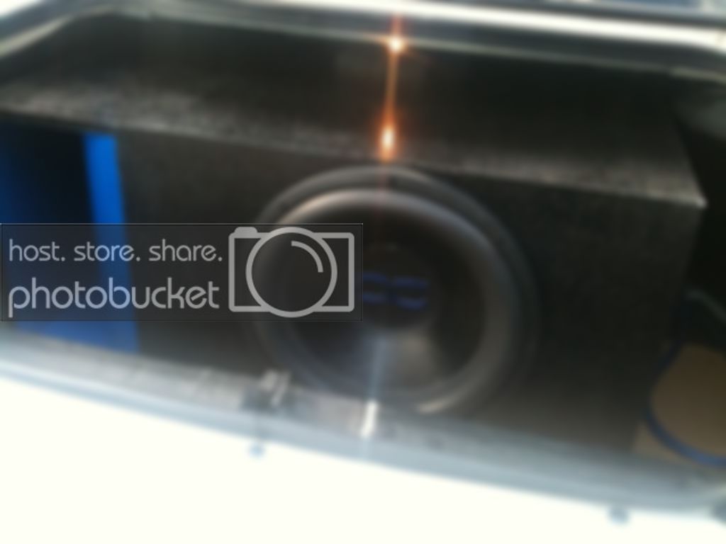

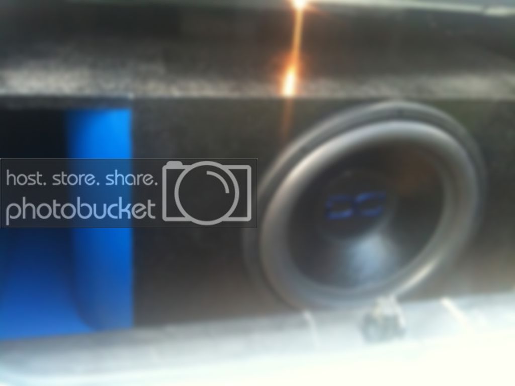

Didnt take pictures along that way but here are the final pictures. Box is for a 15" level 5 and specs of enclosure are 4.0 cubes @ 32.5 hz with kerfed port //content.invisioncic.com/y282845/emoticons/smile.gif.1ebc41e1811405b213edfc4622c41e27.gif Port is actually a dark blue but the flash makes it look like a teal...
thats nice box . I like the spray on liner .How do you like the spray on liner ?
It's a roll on, but have been doing it for a long time so I'm very good at getting it even. //content.invisioncic.com/y282845/emoticons/smile.gif.1ebc41e1811405b213edfc4622c41e27.gif
Yes, the front piece AND port is all one sheet of wood, just kerfed at the right measurement. The bedliner I used was Herculiner.
