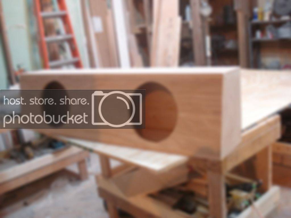

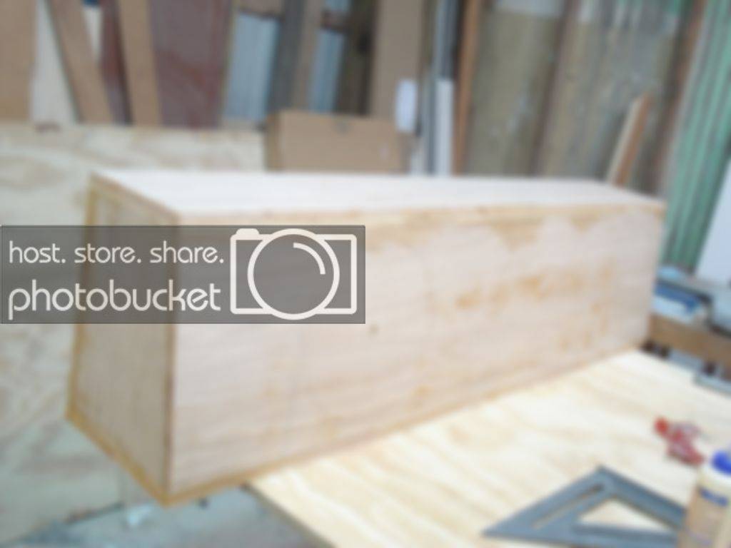

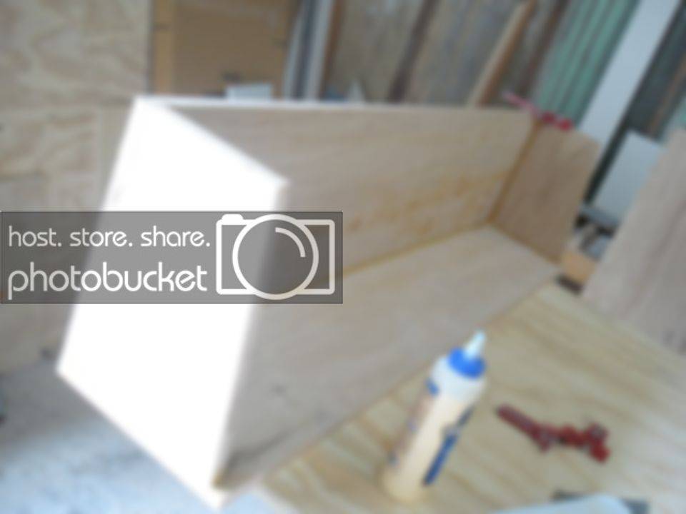

So I finally found time to build a new box for both my pwe304's. The box is sealed with dual chambers. Decided to try birch for this box and so far I really like it. It's a lot lighter and more appealing. They will be powered by an aq1200d at 1ohm.
I haven't figured out how I want to finish the box yet. At first I thought about staining it maybe a light stain. Now the idea of tan vinyl is in my head. Also I may round the corners and edges later on. Let me know what yal think and give ideas.
Overall cuft is 2.8 (1.4x per chamber)
Dimensions are 55w x 14h x 8td x 10bd

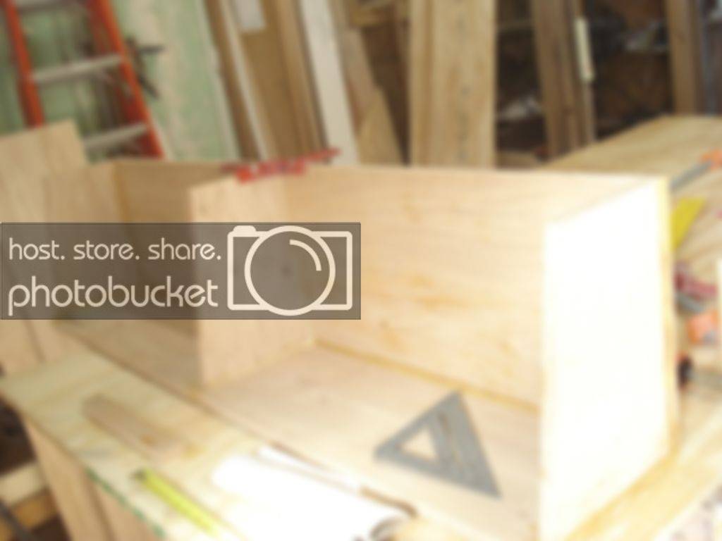

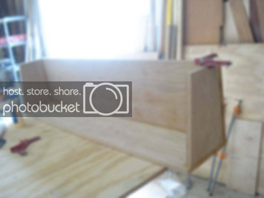

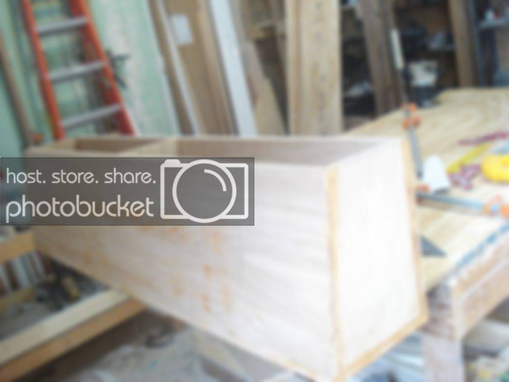

On to some pictures:

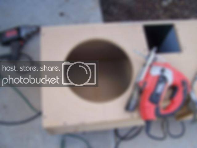

The smaller routers were on the job site and I didn't want to use the mammoth router (weighs about 25lbs) so I went the old fashion way and jigsawed them hoes. Don't make fun //content.invisioncic.com/y282845/emoticons/frown.gif.a3531fa0534503350665a1e957861287.gif

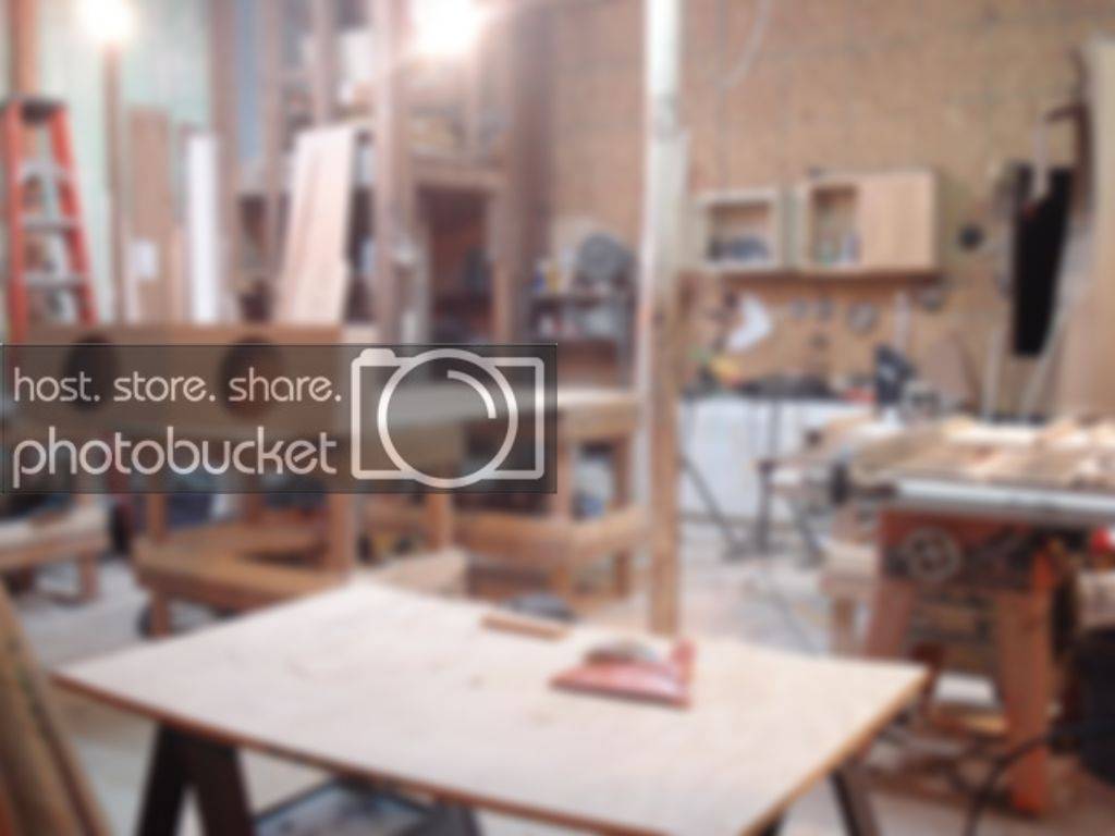

And here is my shop
did you knaw those cutouts man? goodness haha other than that stain that box! oh it would look nice with a dark stain!
also did you go slow with the jigsaw? i can cut the cutouts like perfect with a jigsaw man. you just have to put your face in front of the blade then cut.

Haha it does look rough. I used a 24 tooth blade which caused a lot of splintering //content.invisioncic.com/y282845/emoticons/frown.gif.a3531fa0534503350665a1e957861287.gif I used to use the jigsaw for all my boxes and I'm able to cut perfect holes like you've shown but it was around 9 at night and I was ready to get them done so I rushed...not the smartest idea but should be ok.
I though about a dark stain way before building the box but wasn't sure how it would look with my interior. I have tan interior.

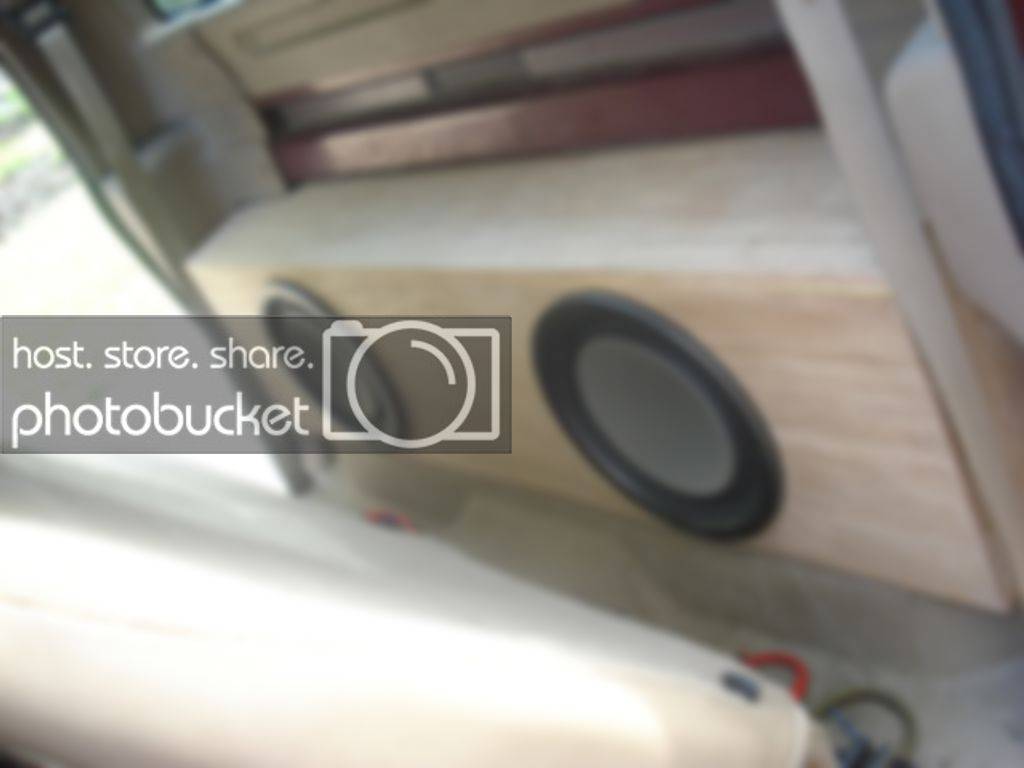

got it installed today and played it for a little while. I'm still breaking in the other sub so nothing special yet. Sounds great though.
Now for pics
Is there a notch in the cutout on the right woofer? Does air pass?
