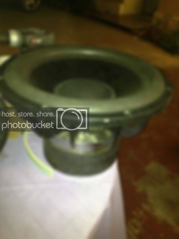

I just bought an re destroyer, its currently in a 4 cube slot ported box and sounds decent but from what ive read about this sub it should be just killing it!
But I cant seem to find any REAL info about it....keep reading that anywhere from 25 to 50 of them were ever made. Thing is a beast, just had everything replaced from re and it is STIFF!
Seems to be getting enough power but idk, just thought a better box would help more than anything.
So im just curious if anyone knows anything about box size for this sub? Im lookin to hit HARD not so much low, i just want bone crushing loud!
Im building the box into my midgate of my avalanche.
Had 1 12" hdc3 built in last year with a pb xa3000 pushin it and it was way louder than this sub as of now, so id imagine that this sub should be able to hand it its *** in the right enclosure.
Dont need measurements, just what cube and id imagine tuning it to about 38-40hz would be about right, so id need to knw how big the port should be. But just incase, my midgate opening is roughly 21h, 47w, depth isnt an issue. Thanks!!!
Oh and any other suggestions about a box setup that might be louder like a 4th order or something would be appreciated! Just whatever will get the loudest for this sub.
