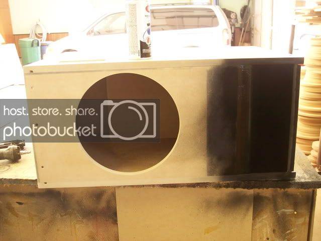

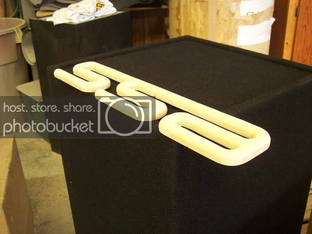

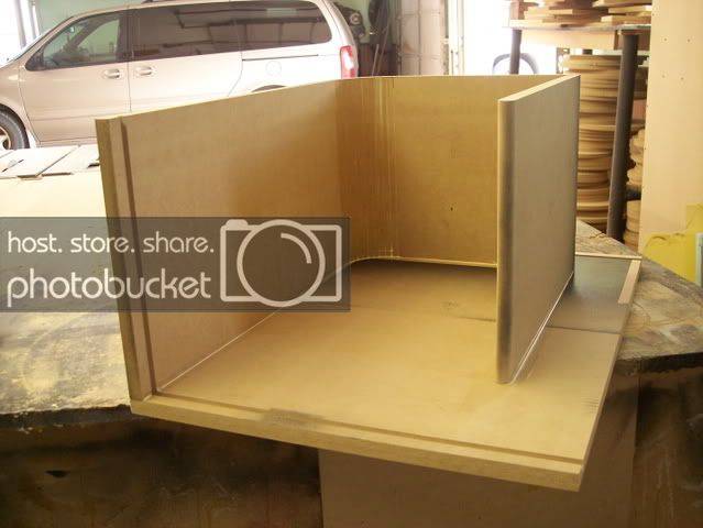

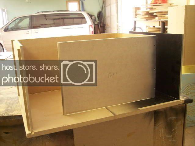

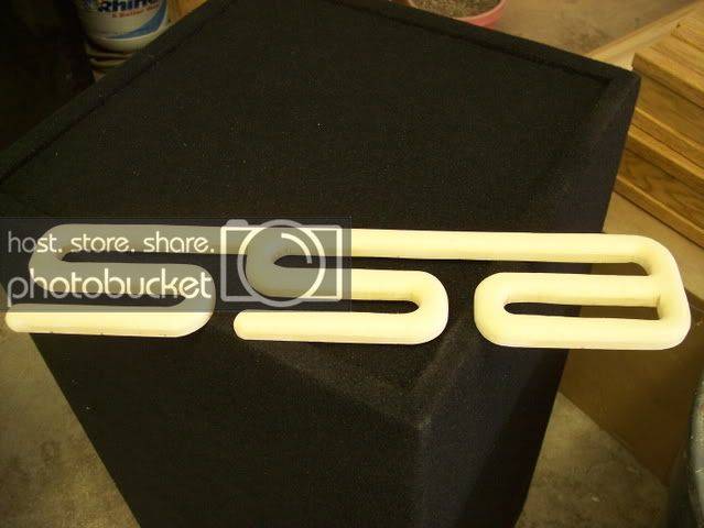

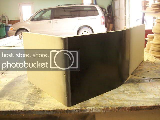

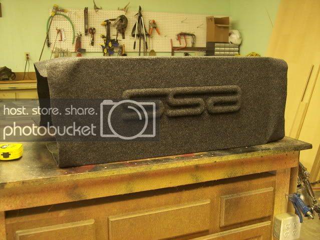

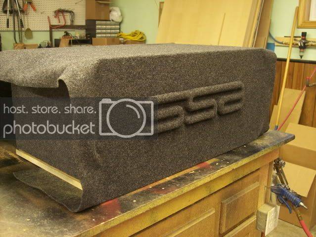

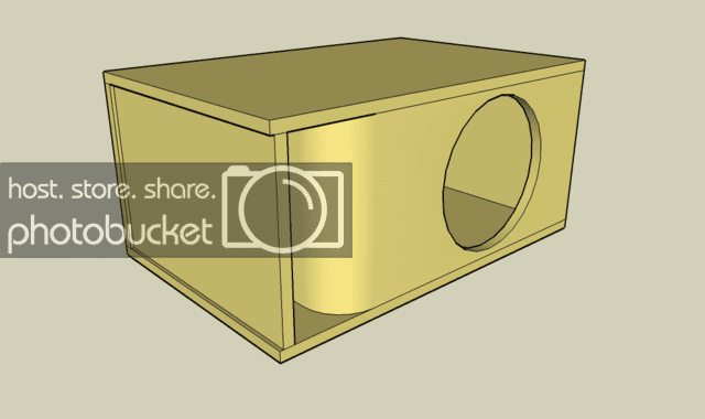

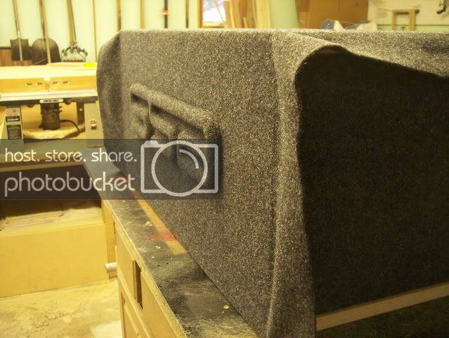

This box is 2.45 cubes @ 33hz for a 12" SSA ICON. Customer wanted a flared port as well as a nice raised SSA logo on the back. So what I decided to do, was use 1/2" MDF to make the logo out of. Ran a 3/8" roundover bit over it to give it a nice rounded edge. Was a little worried that I wouldnt be able to carpet over it, and not get any wrinkles, but it turned out to be not so bad.
I actually almost forgot to add the logo to the enclosure. I was just ready to carpet the back panel when I remembered it. So thats why you dont see it installed prior to carpeting.
Hey Fish, is there a reason you dont round off the inside of the port also(like the outside of the port) just wondering? is it a functional reason? looks awsome though
Are you asking why I dont flare the port bend on the inside too? No real reason I guess. But you probably wont notice a difference, so there is no real reason to charge more.
Thanks to everyone else. The logo was cut with a jig saw, then sanded a little by hand. I didnt quite get it finished like I wanted to last night, so I will finish it up tonight.
