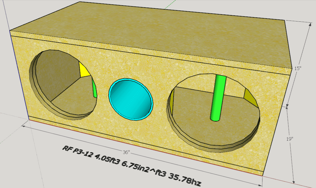

So I have 2 Rockford p3 12's. The current box is sealed and built to the specs on the Rockford site. 14hx36wx10d. I am not really happy with it. I have been told ported is the way to go. Where the heck do I start?lol I do listen to absolutely every type of music. I was told tuning to 40 hz was a good compromise,but I have no clue about this as I have always ran sealed boxes. I definitely wouldn't call myself a sq guy, but I am also not looking to do spl. Maybe a mix of both, loud and accurate I guess. Any advice is greatly appreciated.

Hit up a designer for an enclosure design, it's one of the if not the most important parts of any build... a great sub-stage will floor most people if done right. Tune it for your music tastes, port it for your power and configure it for your vehicle... this was for a Focus (my son's) and it sounded great and went fairly low as well...
That was on a RF 1200? prime... I think. IDK which he was using... he loves my stash.

Go get some shitty wood or cardboard or something and figure out what the max is, play around with different dimensions to see what the max cubic...
