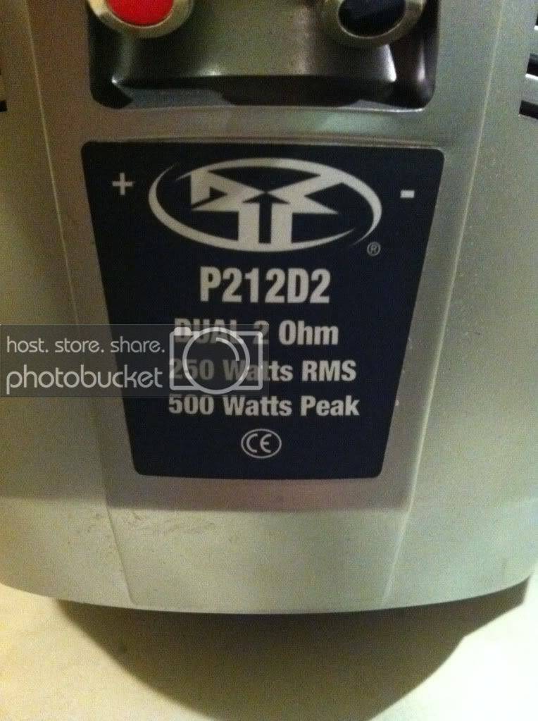

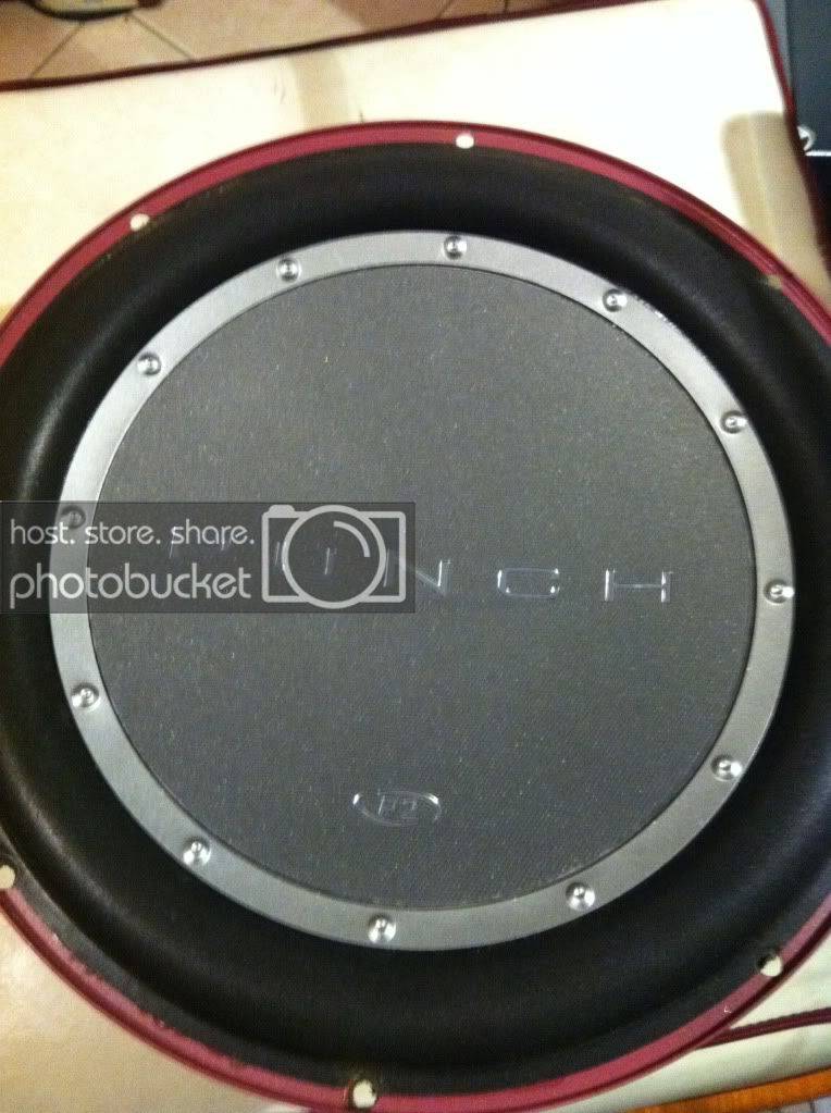

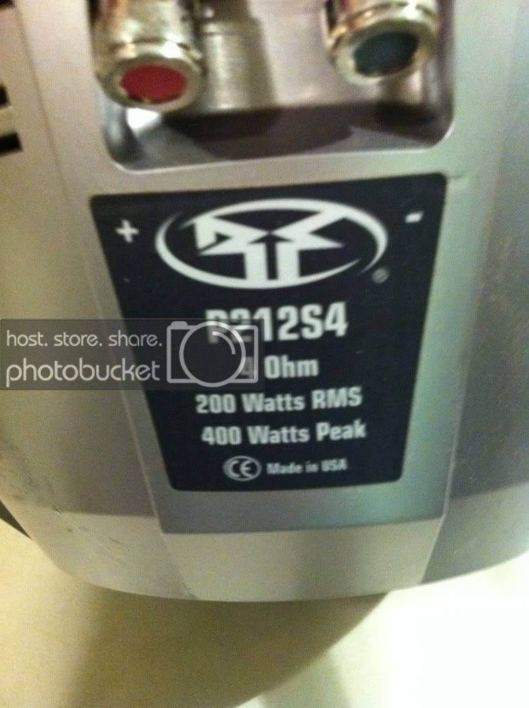

Bought two used subwoofers with enclosure, 2 different subs
Here are some pics if you guys want.

my friend has had a very bad experience with the newer punch subs not good quality idk by no means is this a post dumb just from what I've heard they are not good they sound thin to me and. Mods this is not a post dumb. I would sale. And go with some db drive k3s or k5s or something just my two cent.
Use em why not you already purchased them on the dvc wire the coils in series then wire the subs parallel. Should see a 2 ohm final load to the amp. They may b different year model subs. I have an old rf p1 8 ohm 100 rms from back in the day the newer models are 200 or 250 on the same versions @ 4 ohm.
I'm not following.... on the dvc sub, 2+2= 4 ohms-----------> paralleled to the already single 4 ohm sub....would result in 2 ohms final....and equal power to both subs since they're each at 4 ohms individually...

I know voltage is constant in a parallel circuit. But I was thinking more of in respect to each sub as opposed to each coil. Even if u were to parallel each coil, the 2 ohm coils would see more power still than the 4 ohm one. Voltage would be equal but current wouldn't....atleast from my knowledge.
Ok so if i decide to keep them (im not sure if i want to sell or use them at this point), how should i wire them and what would the total rms watts be to find an amp? Sorry but im a noob at this lol
