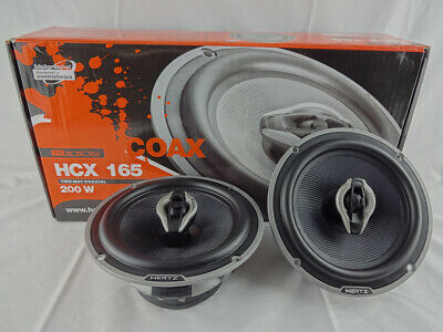

For drop ins, These have always done very well for me..Even on 50 rms power. The MM series for Components do very nice as well.
Have a pair of these on a 125x2@4 ohms on one of my amps and they sound pretty clean for drop ins also.
