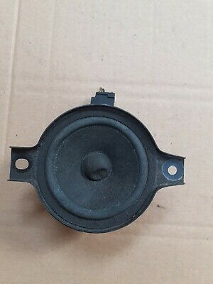

The factory speakers are all 20W 4ohm I believe, there are coax in the rear doors and a "wooofer" in the front doors and a mini speaker in the dash which has a capacitor on it and is inline with the front door speakers I think as there are only 4 pair of speaker wires. I cant find an adaptor anywhere for the dash speakers.
