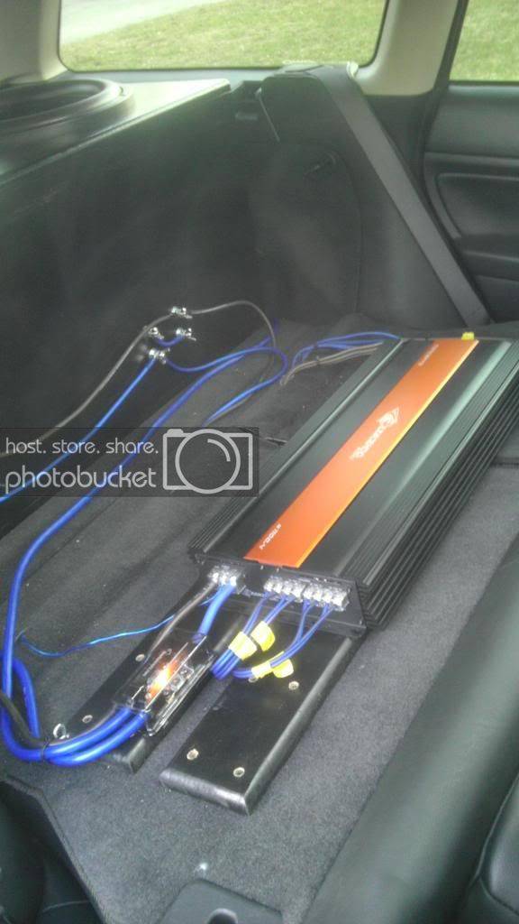

I really dont know what else to call them but anyway. I have seen several times ppl using bolts and nuts for the box terminals. Basically drill two holes in the back of the box and put in 2 bolts with wires w/ring terminals from the speakers to the bolts. Then on the outside of the box wire and ring terminal to the ends of the bolt protruding from the box. I added a pic I found online.
The question is, is this a better design than just drilling one hole for the speaker wire and silicon it?
Wow...I haven't seen that pic in a long time.
That is from a 2-L5 15" build I did in a Ranger over 10yrs ago. I guess you stumbled across my old CarDomain page...lol
To answer your question, pretty much the only reason I use this design is to rewire subs to different loads outside the box.
Thats awesome what are the odds that the random pic I chose would be a member from here lol. Especially if its a ten year old pic. It also goes to show once you put something online its there forever.
