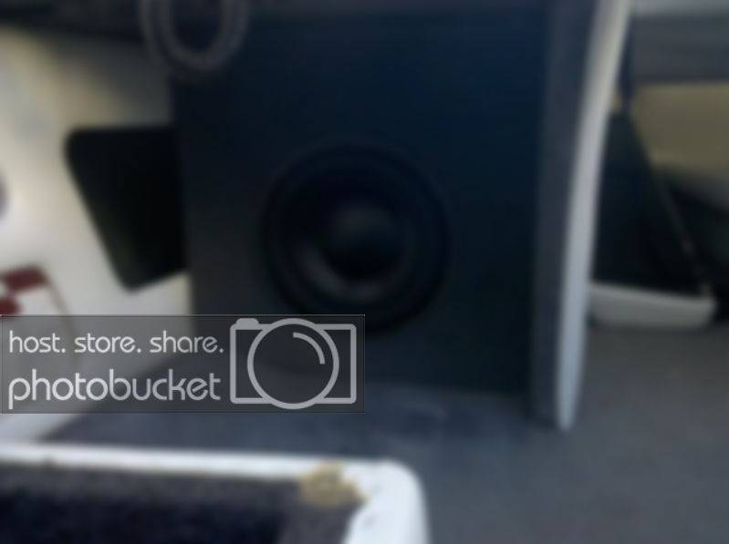

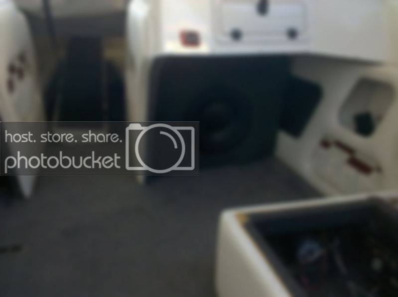

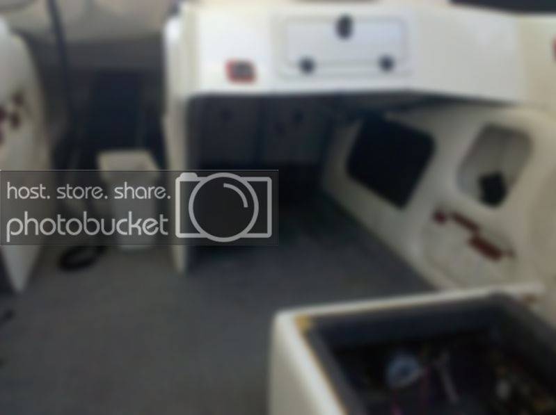

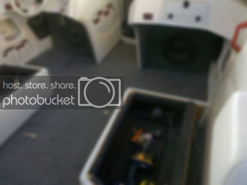

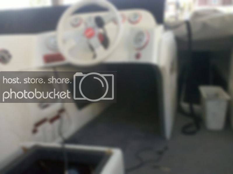

i did this to mine, not sure how much room you have in these spots but here is a idea..
Each have 1.75 cubes ported to 35 hz, port fires to the side of the boat. suckers get loud for only 800 rms
the sub is an alpine type r 1242d. i can't put the sub under the helm or port side, i would love to but i use that space already. I can't face the sub parallel to the floor because there is not enough space to mount it. I Love the 4th order bandpass, so do i build the enclosure so the port is facing towards the rear and not deal with the seat? And what volume am i shooting for? I only have specs for sealed and ported.
-Brian
oh wow...something I know about. Allow me to share my experience. Ironically, I had to exact same sub you had the last 2 seasons on my boat. I think doing a sealed enclosure is kind of a waste. You definitely want ported if you want output. If you have a ported enclosure on a boat the best place to put is under the driver or passenger console with the sub and port firing at the hull. If you can't use this space for a sub than I wouldn't waste time trying other options. Ported will be fine as far as moisture...just epoxy resin the box inside and out. You want to tune the port higher on a boat than you would in a car. Sub firing into open enviornment won't produce the results you're looking for. I'm installing a Sundown Z15 v.2 on my boat atm 3.25^ft @ 35hz, can't wait to see how that does at party cove //content.invisioncic.com/y282845/emoticons/smile.gif.1ebc41e1811405b213edfc4622c41e27.gif
