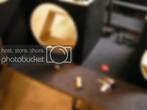

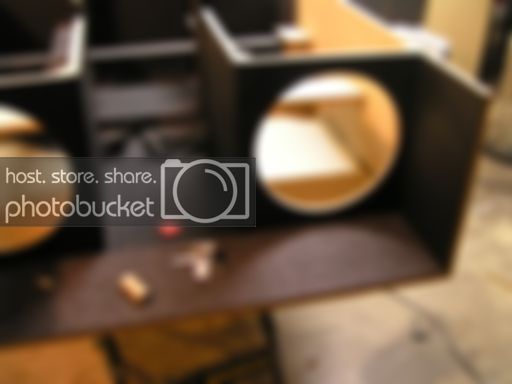

BLOW THRU in an '03 Silverado xCab/Escalade
Close up #3.
Close up #4.
The whole bed is covered in black vinyl as well as the cut through, the only slightly visible thing will be the rounded edges of the front of the port....without a 3w LED flashlight. Everything is so dark when installed...and the bottom/top of the front chamber and port will be carpeted with a design in them. Hopefully he does not opt for another Caddillac symbol right?!
Confucious told me that 225+sq" don't give a flying sheet if it were lined with 20-grit.
heh heh..... It don't matter with this setup. I've done painted wood, vinyl, carpet....they all get retarded several blocks away. I did carpet on the bottom to break up the monotony of the all-black vinyl. It just so happened to be what the guy asked for also. That particular shade of carpet would not have been my choice. I even tried to get him to break it up with factory matching tan vinyl. Customer is always right. If he isn't....I get paid to pull it and paid to do it in something else he wants instead.
