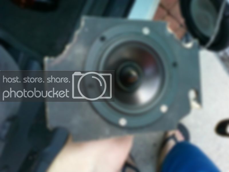

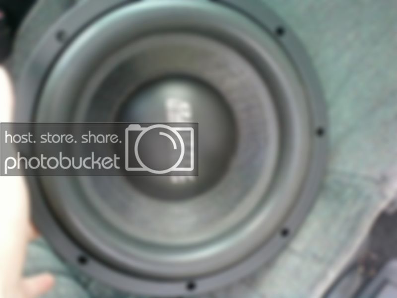

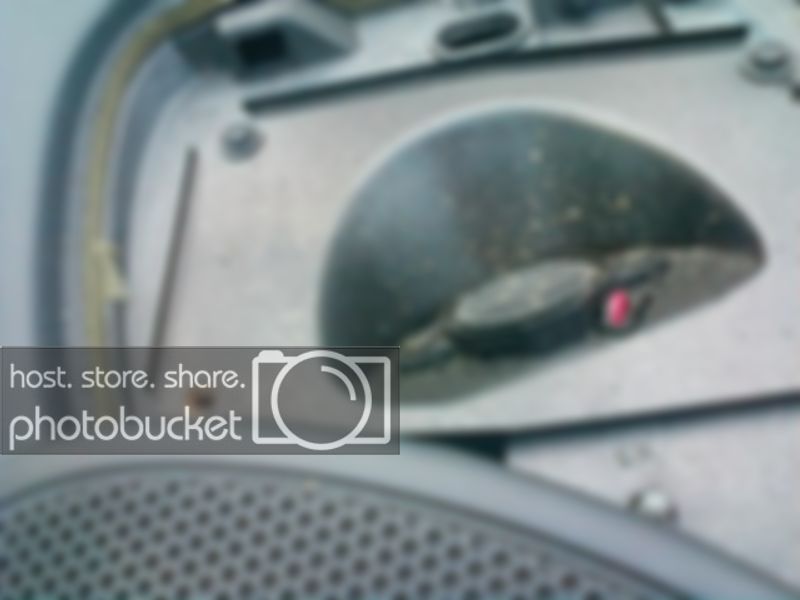

Been doing the front stage for about 3-4 months now. Here are some pics! Sub stage coming soon.
Don't laugh at a couple. This is the first time doing any of this so bear with me, lol. On to a bunch of pics!

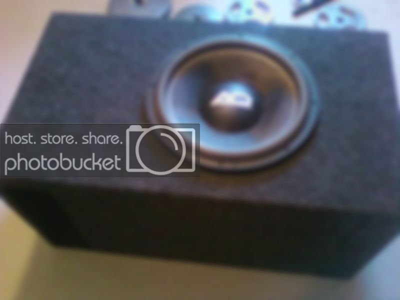

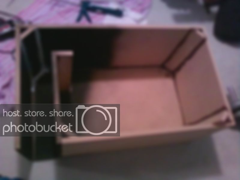

Here are a couple of my Hdc3 15 box I built.

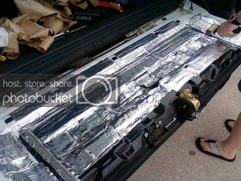

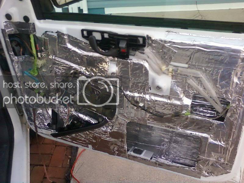

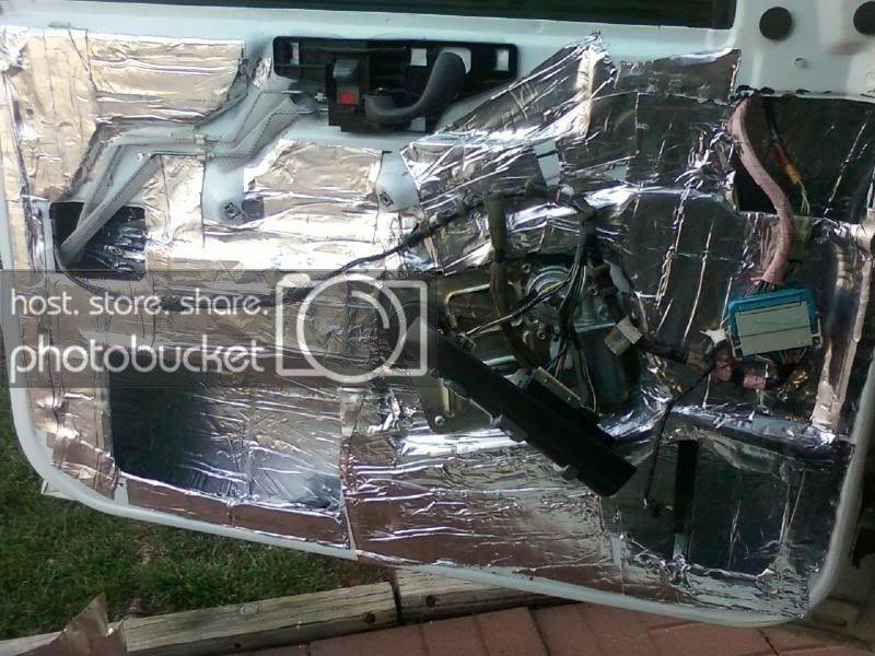

A few of my deadener pics. Audio Technix FTW! I have a thread with all the pics in the AT section.

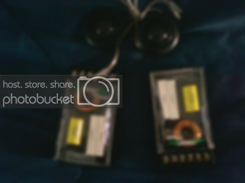

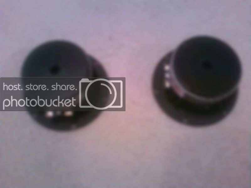

Daytons....

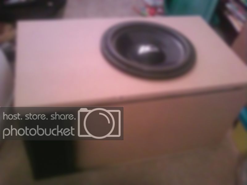

Ok...never did fiberglass before so I tried something else...plastic putty! Lol!
It's not the best looking....but I think with more sanding and smoothing, it would've been better but again...first time.....I think it'll serve it's purpose.

How did you cut the 45's? And did you follow a tutorial on carpetting? I'm afraid to carpet my box and have it look like trash //content.invisioncic.com/y282845/emoticons/crap.gif.7f4dd41e3e9b23fbd170a1ee6f65cecc.gif
Just used a table saw, just turned it to 45....or something, lol. And let a rip. I can get a pic if you want.
As for the carpet....I tried to watch videos and stuff but to be honest, I just went with it. The sides don't look the best. But it's pretty good. Just wrap the whole box with carpet then you should have 2 sides with extra carpet. Slice the corners and fit it like a puzzle.

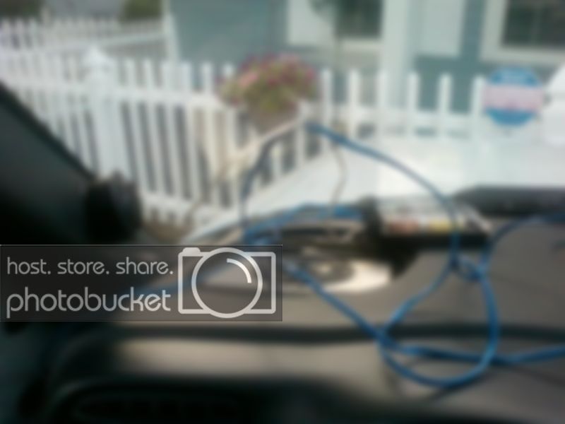

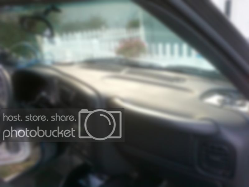

Got the door panels back on and vaccumed the car
Got a competition coming up....My box goes over the back seat a little...So i'm thinking of building a box for the sa and running that!

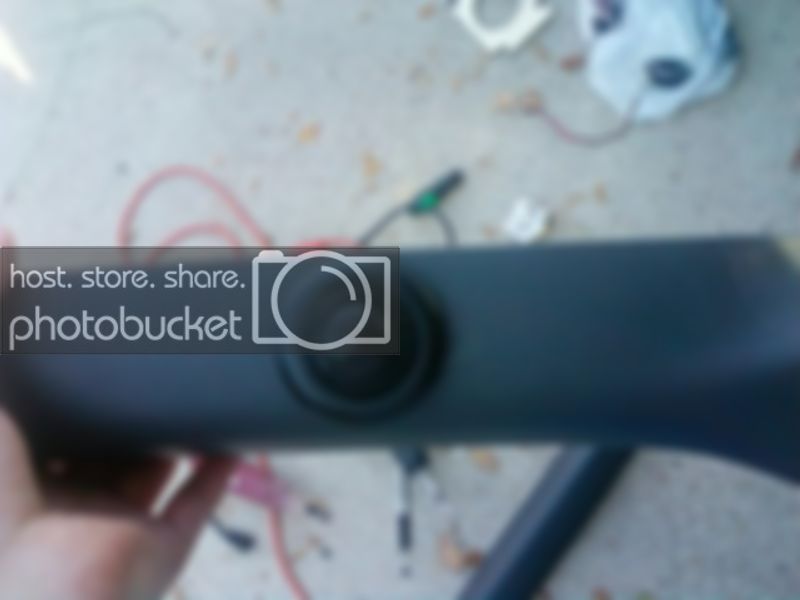

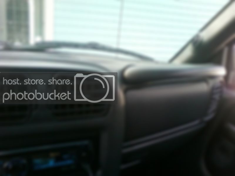

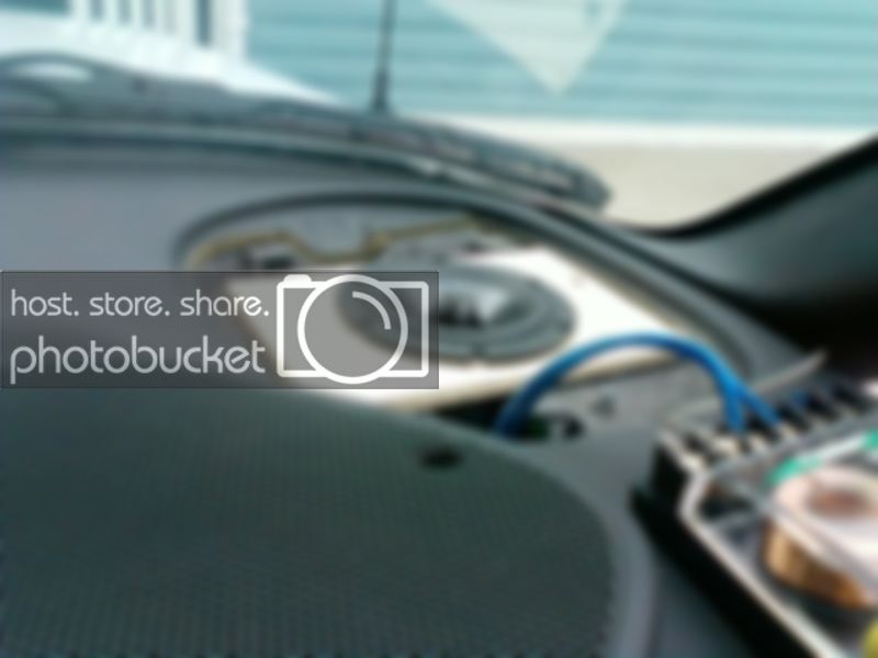

Not bad . Word of advice, cover those holes around the mids in the dash and your sound from them will improve 10 fold //content.invisioncic.com/y282845/emoticons/smile.gif.1ebc41e1811405b213edfc4622c41e27.gif
I would have to agree with that....
Nice start though. The only thing I would say would be next time round the port edges over inside and outside the enclosure. If you don't have a router just hit it with some 80 grit for min will work fine.
Still a good start and should sound pretty good. Hope put some deadener in the roof...they flex a lot lol
Ok. I will do it today and see!
It was my second enclosure built. I will remember that for next time! What's the advantages? Just smoother flow?
If I knew how to take the liner off of the roof, I would...hmm....
Headliner is easy in the blazer. Just pull down all the side panels and go from there...you will need another set of hands or two to get it out of the truck with out damaging it though.
