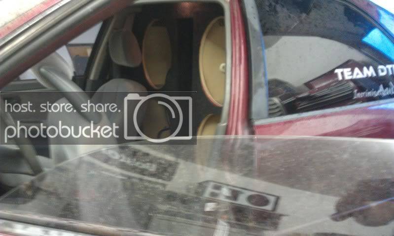

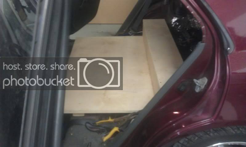

this is what he had before

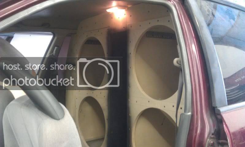

now...

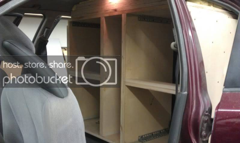

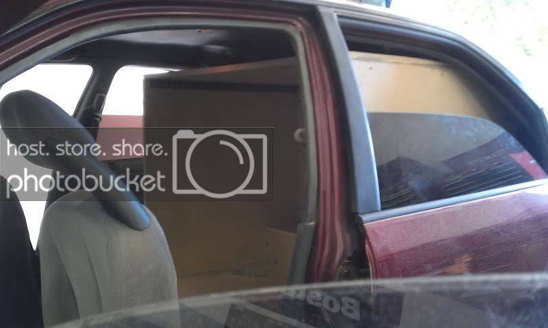

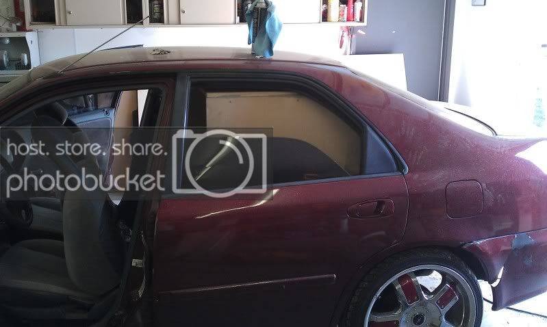

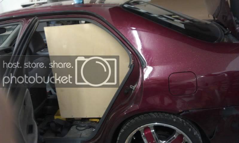

(and dont get excited thinking your gonna see a bunch of fancy **** on this one cuz this is just a basic wall .. just need to get him louder! haha since hes the only one on the team thats not in the 50's

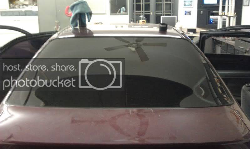

spent an hour scraping off the old tint
new tint....its called Rustoleum Premium Enamel haha

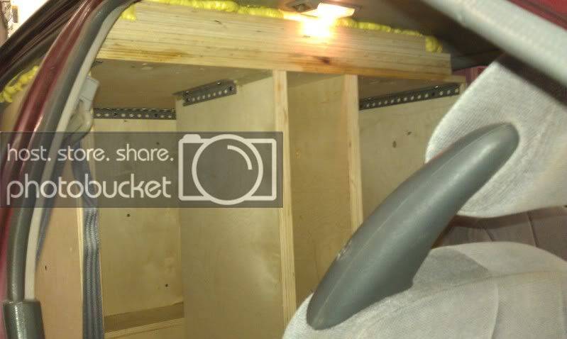

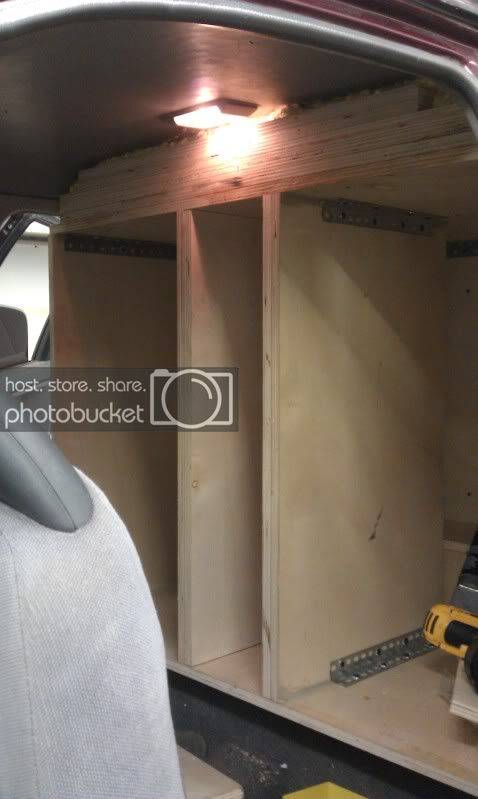

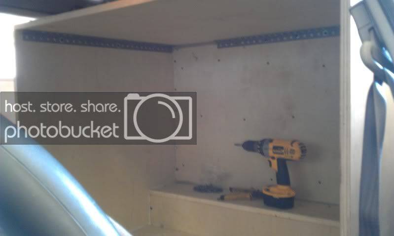

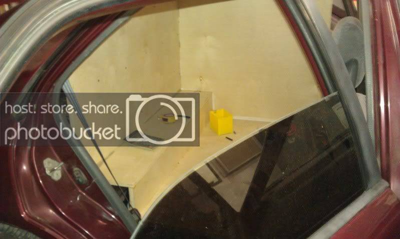

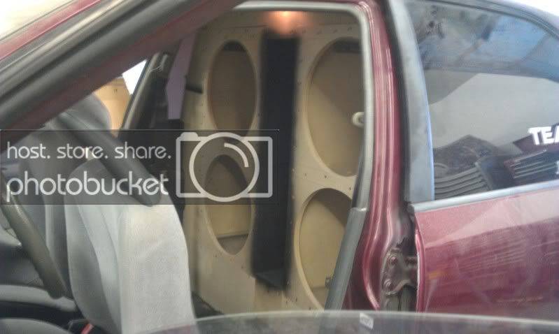

this is the first wall i have built inside a car, so the top kinda worried me not being screwed into wood... so on top of the 1/8" steel angle and PL Premium advanced i layer the top with 6 pieces for added stiffnes with the scraps i had left over... they go almsot to the back

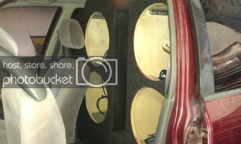

more bracing.. again never built one in a car so i had to make it sturdy regardless of the small amount of power... i also will only beable to single later the baffle... which isnt a problem considering 4 screws from each woofer will be in a brace...
woofers will come later
