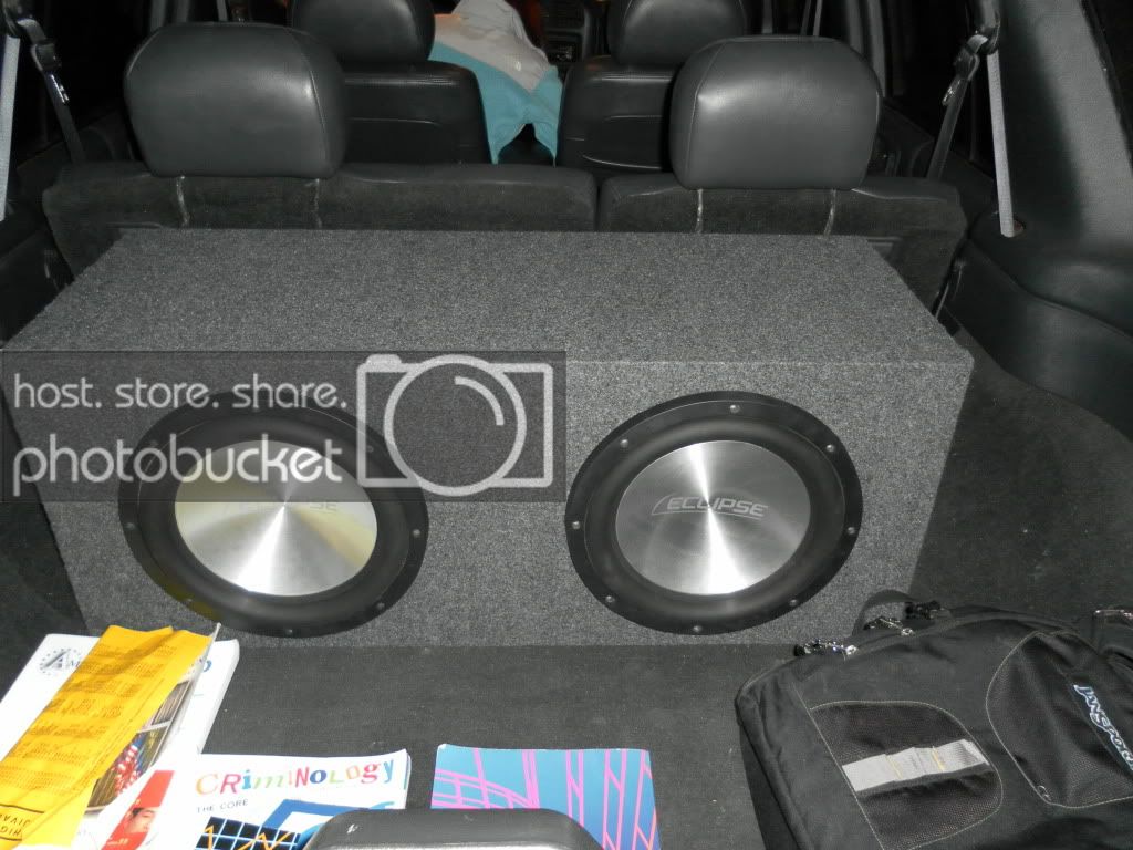

ow big was your old box? What was your old box tuned to? What is your new box tuned to? Still using the same amp and speakers are wired the same way gains set the same?
The other box was close to 4 cu ft^2. I didn't build it so i am not sure what it was tuned too. The subs are stilled wired to 1.5 ohms. and didnt touch the gains until now but it still sounds weird. In the old box it just seemed louder now it seems like the subs have too much power or something
Even if the old enclosure was sealed, subs generally become more efficient when installed in larger, sealed enclosures.
If the old one was ported, it would generally be louder at the port tuning frequency than a smaller sealed enclosure. I've seen the differences from as low as 3 dB to as high as 12 dB using the same subs ported versus sealed.
