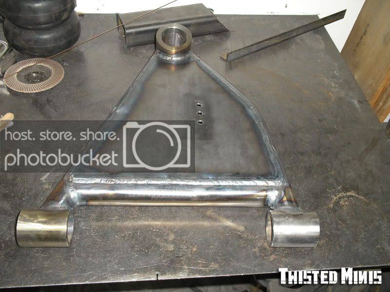

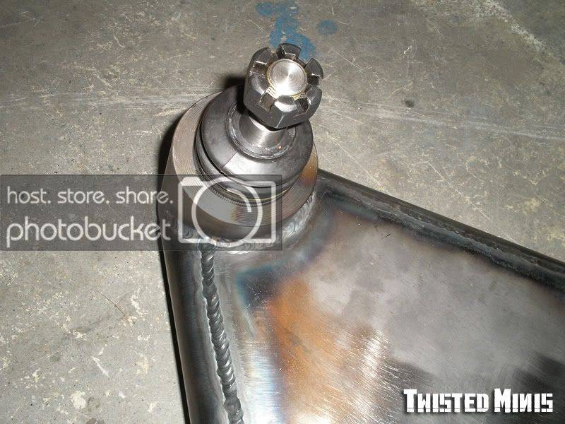

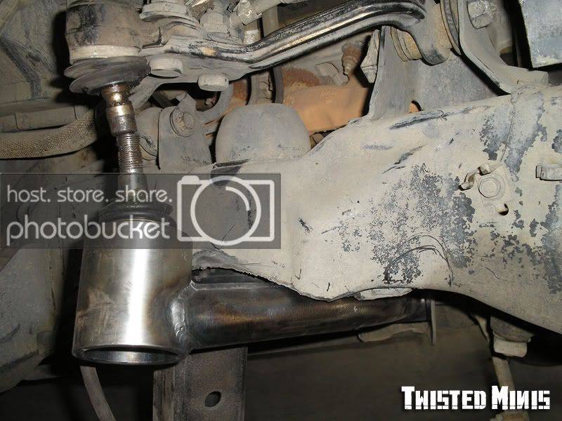

The arms are just about done got new ball joints installed so the spindals can go on soon.
Dang thats some fabrication skills for sure. Looking awesome so far. If the car comes out looking half as good as just those control arms then its gonna be insane.

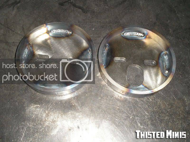

Bag cups

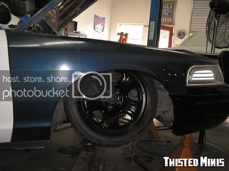

Getting an idea of how low it will lay.
Man I haven't logged in in months, but I still follow this thread threw my email updates. I had to say I'm getting really excited for you lol. What vehicle are those wheels off of? They look like the F-150 steelies, but they're 5-lug so I know they aren't. Did I miss it? They look like the Charger police package wheels too...
yup they are charger police wheels. i picked them up from a dodge dealer for about $500 i have the center caps and all. i just need to re drill my hubs so they will fit correctly. As they sit right now there is a 7/10 of a mm difference in the bolt pattern between my ford and the charger. as for the rear the jag rear end isnt anywhere close to a dodge bolt pattern so those are getting re drilled soon.

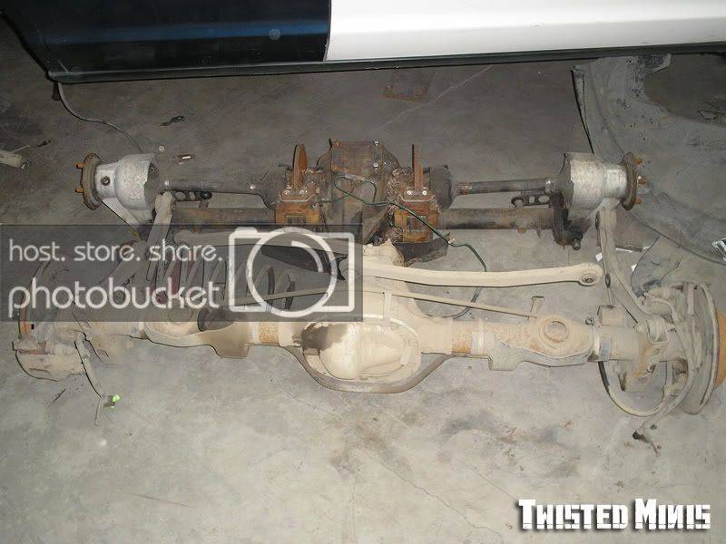

The rear axel was finally removed Seth said it was a pain in the @ss to get out. heres a shot of it next to the jag rear end.

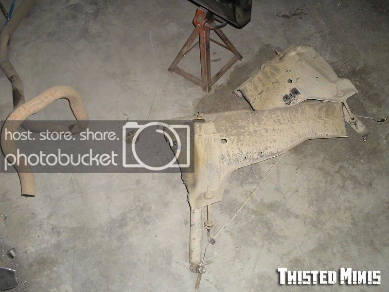

heres some sort of sheet metal cross member that was attached to the axel
