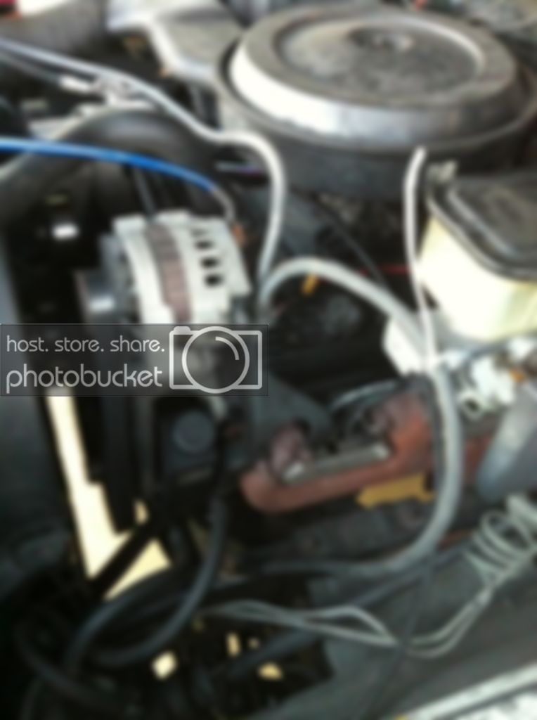

ignore the 4 guage blue power wire on this photo - i replaced it with red 1/0 when i finaly got the propper size anl fuzes and fuze blocks...
but this picture shows my negative run. starting at the battery negative - it runs over to a bolt that holds the alternator in place - and since im using the dual 1/0 wire terminal blocks - i used the other wire coming directly off of that to jump over and down and mount directly on my frame rail.

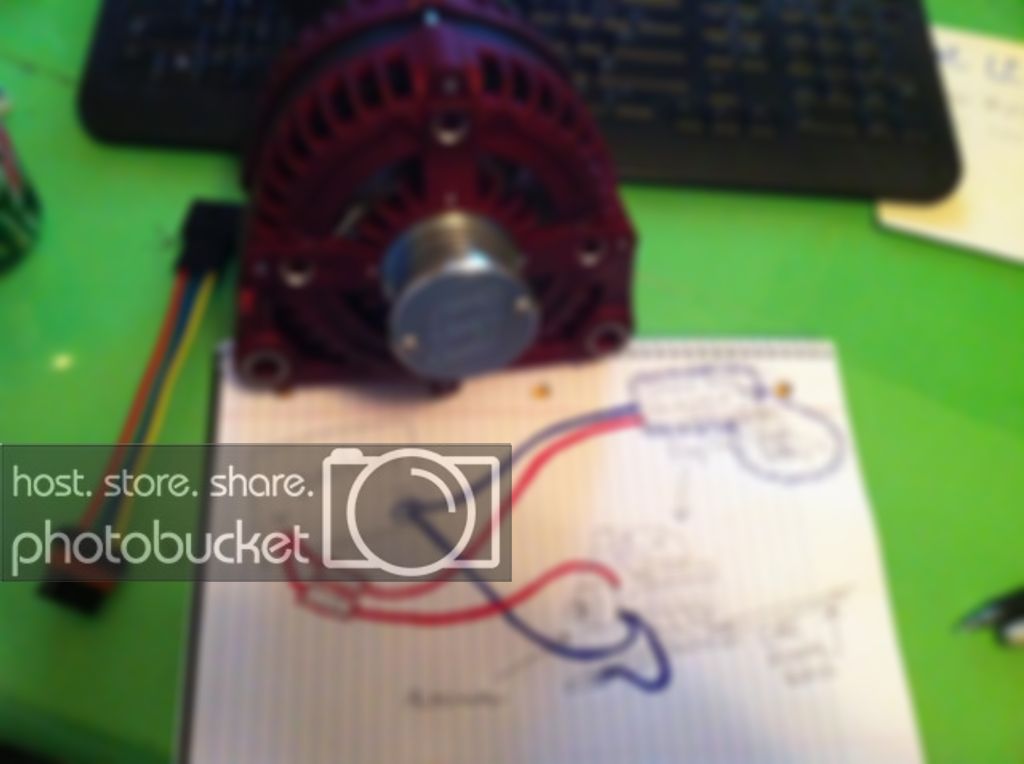

simple drawing for anyone still not 100% shure what to do

Oh ok thats pretty clear now, Ive always thought itd be a bad idea to run the neg from the amp to the batt negative

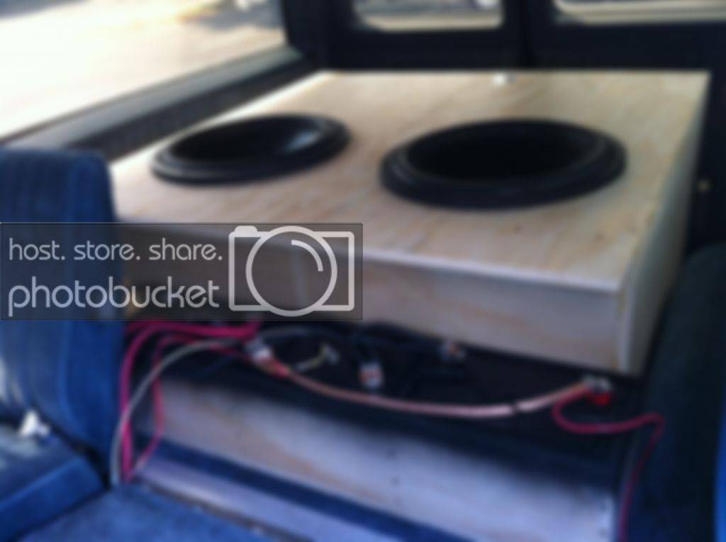

also in my system - my runs of positive and negative to the rear go to the back battery bank. then the amps are wired from the back battery bank + and -
please excuse my messy wiring back there - im in the process of moving stuff around still
