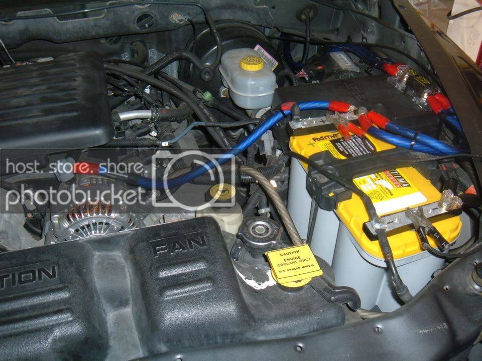

A G31 dropped right in my battery tray.
**** matrxx dude! but i got all my ABS lines right there, cant really move them around //content.invisioncic.com/y282845/emoticons/frown.gif.a3531fa0534503350665a1e957861287.gif. its a 98
skrilla: you dont have to use that top bolt, you can bolt it to any one of the 3 bolts if one of them will come off easier. hell you can use any bolt on the block really. the point is, just to skip grounding to the chassis, and going striaght to the batt neg
skip: hes skipping the engine block to chassis ground, and is going straight from the alt case (still considered the block) and grounding straight to the batt neg.
Skip, wshat George is telling you to do, you can see I did on my Alternator.

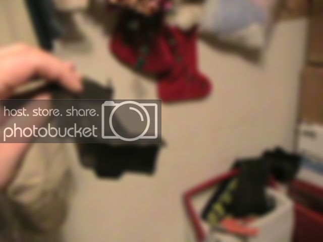

hahahaha......im goin right now and take some...i dont have any of it goin in cuz it was a pain in the *** to me.....i went in thinking its just a direct drop in haha...welp theyll be up in 20min
Welp here they are:
This is what i cut off all around the battery tray....i couldnt fit it flat without it off
Yes, i see that nasty corrosion on the terminal haha, ima clean it up when i run my 4 runs of 1/0 to the back and get new terminals
