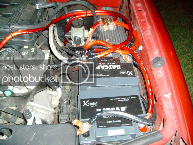

Heres mine on 04 Explorer....you have to break a lil of the plastic off the alt bolt surround to get a 1/0 ring terminal on it...at least i did
Thats the only one i bothered doing

can you post pics of getting the kinetik in there?
and BTW, i too had to break the little plastic nub off the alt to fit a 1/0 ring terminal and so did a buddy. both explorers, but im sure its pretty common with just about all alternators.

Yehhh i had to do that on my Civic....crazy engineers...they knew we was gonna wanna put 1/0 ring terminals on it
But when i said pics of it goin in i just meant its in haha....but mann it was a ***** cuz i didnt know how to do it at first haha.
But i trimmed the batt tray sides and put it in sideways and it fits like it was meant to go in //content.invisioncic.com/y282845/emoticons/biggrin.gif.d71a5d36fcbab170f2364c9f2e3946cb.gif

Yehh i just took the tray out and just cut all the ends off so just the bottom was left so it could sit on it and it fit right in after that but ill get some pics tomm in daylight...i might change my terminal to

Yehh you can....but i did not...it wont move if its on the original tray.....but yeh could could still strap it to the original tray, just cut a slit in it and run something through and around...but pics in 20min maybe
