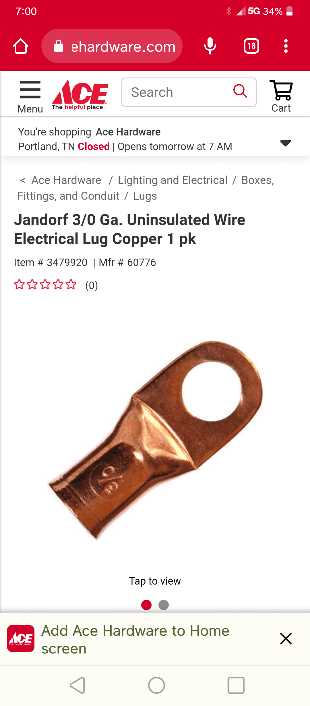

Bought these for my new setup.1/0 awg power wire and grounds fit perfect.
