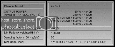

Front Stage and Rear Fill....Hertz HDP-4 (1000w amp)

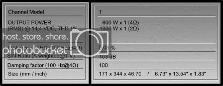

Along with this for my Sub Stage....Hertz HDP-1 (1000w amp)

links didnt work for me....but I'm assuming you're referring to the HDP 4 for your fronts and rears and HDP 1 for the sub. they seem to be very nice amps. I doubt I could justify buying em over something else of equal quality for less though. Alot of Hertz stuff is overpriced IMO from Amps to comps. But, hey, if it'll make u feel better to know you have Hertz Powaahh, more powah to ya! If I had it to blow, I might give em a try too.
