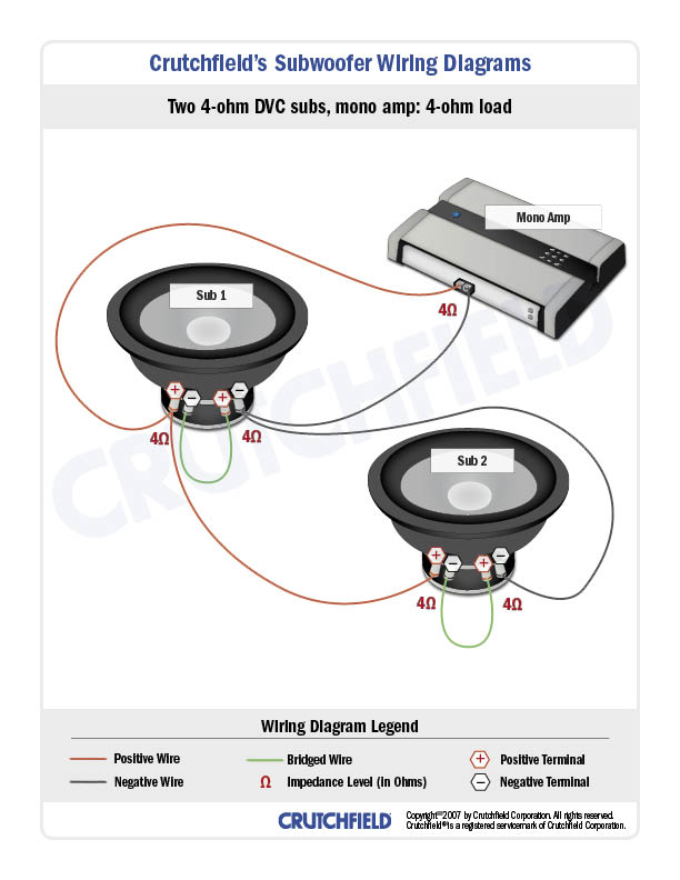

i currently have it wired like this:
if the subs are infact 4 ohm, does that mean the amp is only putting out 220W for the both of them? or does the power output of the amp depend on the way you wire the set up? or is there a resistance switch on the amp to change between 4 and 2 ohm?

Looks to me like you have DVC 4 ohm subs, so you have them wired up correctly for that amp. With those subs you can have them wired in series (like you have shown in the picture) to get you a 4 ohm load, however, if you wired them in parallel you will end up with a 1 ohm load. What I'm trying to say is that, with that amp your only option is to wire them up at 4 ohms since your amp is stable at 1 ohm. To change this you will need to get new subs that are DVC 2 ohm subs and wire them in series, which will get you a 2 ohm load to get the full power out of that amp. //content.invisioncic.com/y282845/emoticons/smile.gif.1ebc41e1811405b213edfc4622c41e27.gif
Looks to me like you have DVC 4 ohm subs, so you have them wired up correctly for that amp. With those subs you can have them wired in series (like you have shown in the picture) to get you a 4 ohm load, however, if you wired them in parallel you will end up with a 1 ohm load. What I'm trying to say is that, with that amp your only option is to wire them up at 4 ohms since your amp is not stable at 1 ohm. To change this you will need to get new subs that are DVC 2 ohm subs and wire them in series, which will get you a 2 ohm load to get the full power out of that amp. //content.invisioncic.com/y282845/emoticons/smile.gif.1ebc41e1811405b213edfc4622c41e27.gif

This picture might be more easier to understand.
ok, so right now i have a 4 ohm load on my amp. does that mean it is putting out the 220W RMS (as the amp says it can do at 4 ohm) to both subs, as in 110W to each sub? im not sure if the power gets divided by 2 when hooked up this way or not.
