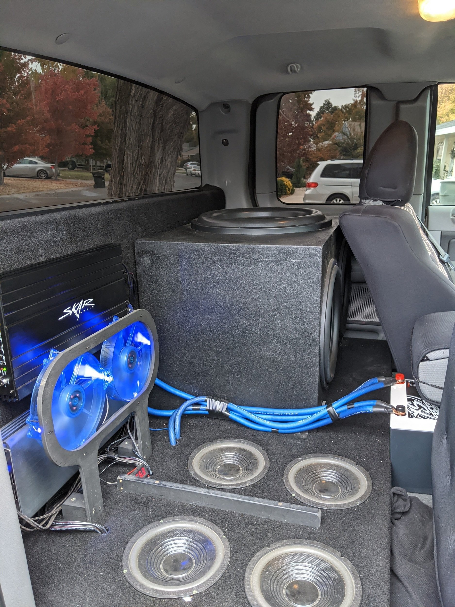

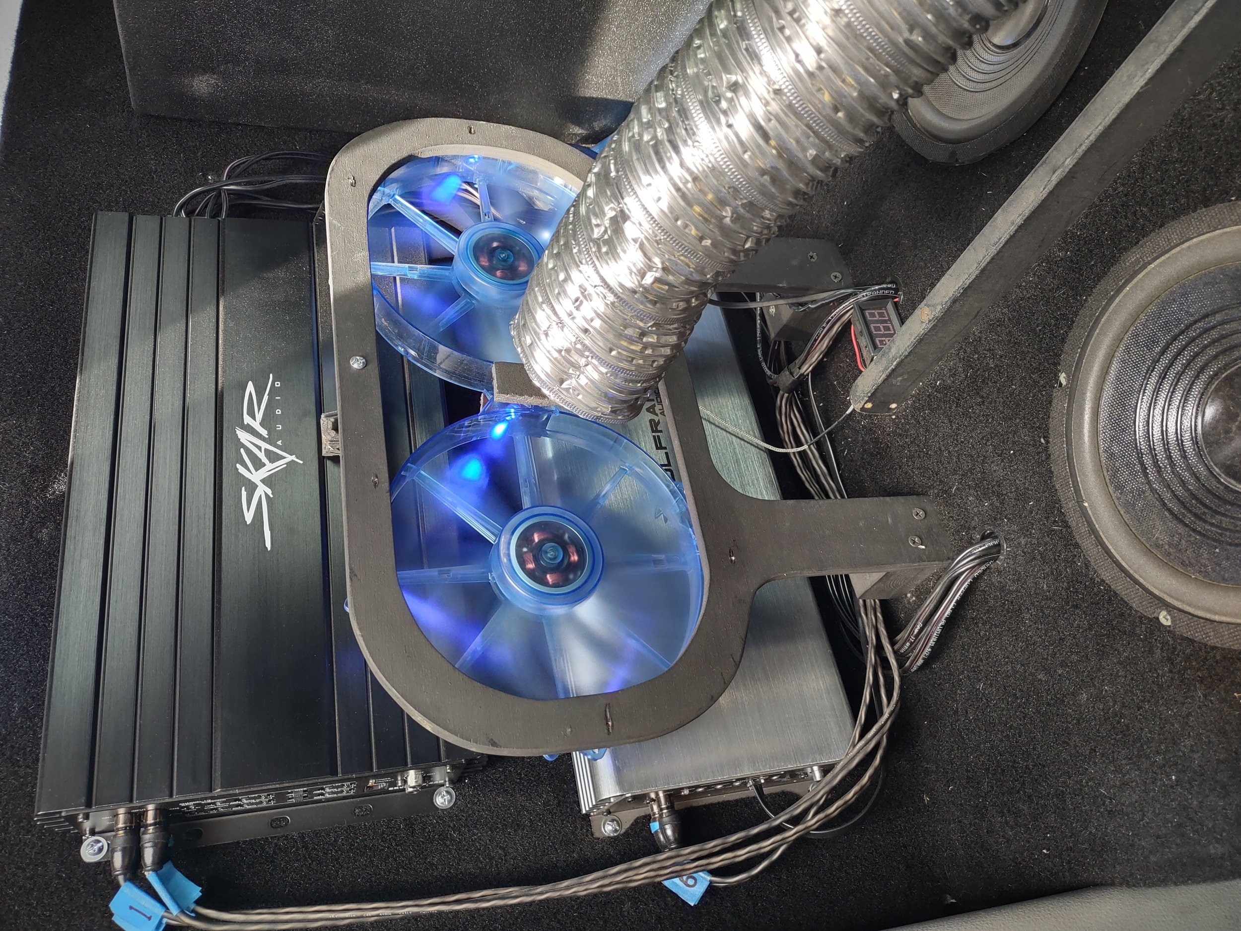

All of this ^ plus I have a couple of PC case fans mounted in front of my amps + I have routed the back seat air (I ripped the back seats completely out, 2 weeks after I bought it brand new in 08') through dryer duct, and right into the center of my fans....
So, as I say, I can now play it indefinitely without it overheating. I just had to jump through 14 hoops to make it happen.... Which I know is kind of goofy, but it works.
But about amps, I had asked about a great value 3Kwt amp... But the best I could find were 3500 wt Skars.... Then I saw that Williston tested those at nearly 3800 ! I'm all for dynamic headroom.... But on my 1600 watt sub, whew, I dunno ?! Granted, actual wattage getting to the sub out of 3800 would probably be about 2600-2800.... But that's still quite a bit for a 1600 watt sub.... Hmmm.
About my hokie rigged cooling 🤪 Looks pretty goofy, right ? But it works. I have a temp gage on the amp (bottom center) that I can easily see from the driver seat, and I'm always watching it.
