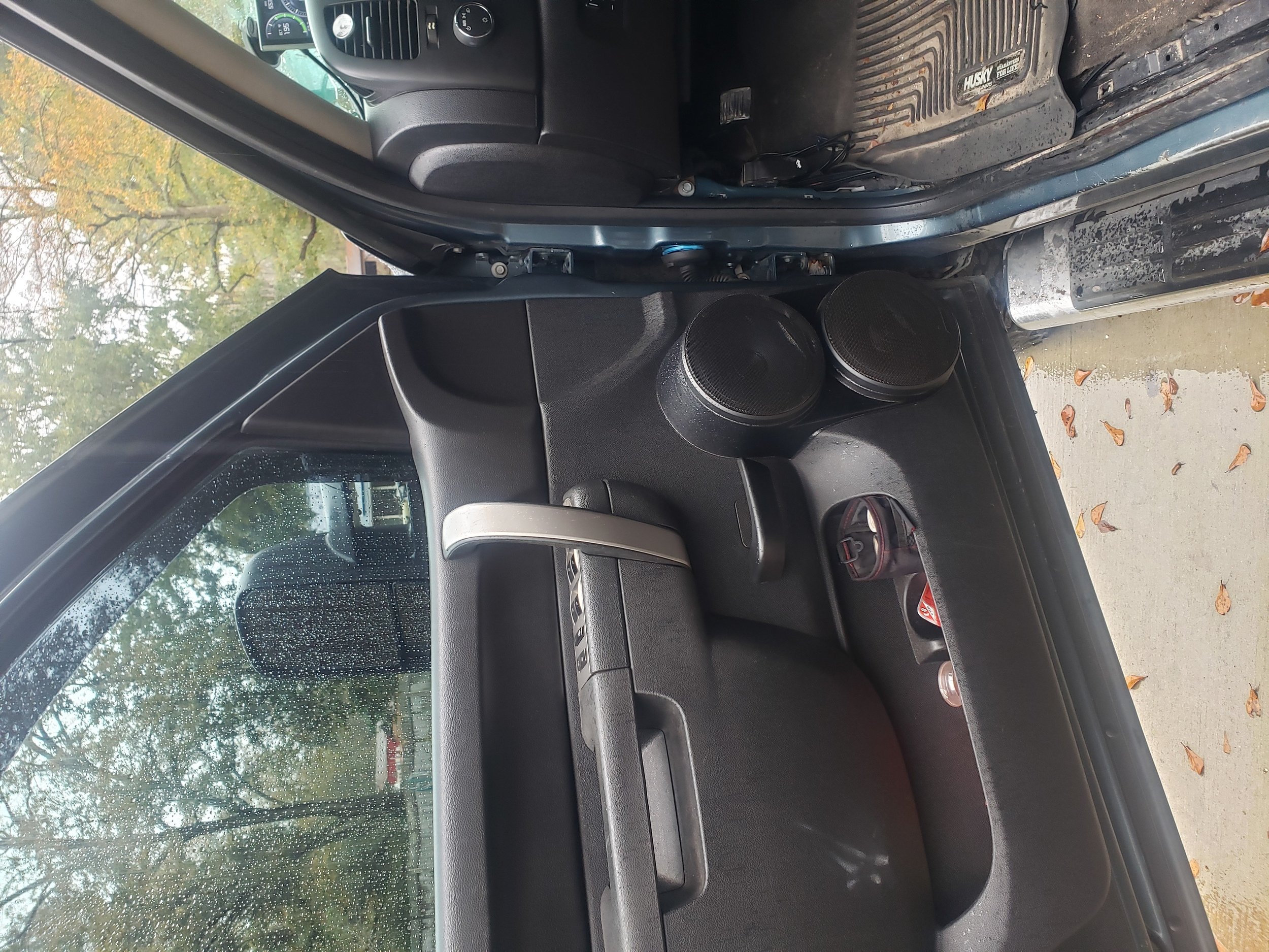

I did put a good bit of sound deadening in doors, 6.5's are in stock locations using the speaker pods to install dual 6.5's in front. Playing around with tweeter locations now & it's helping. Running the crossovers that came I the comps & have tried both deck & amps for main crossovers.
