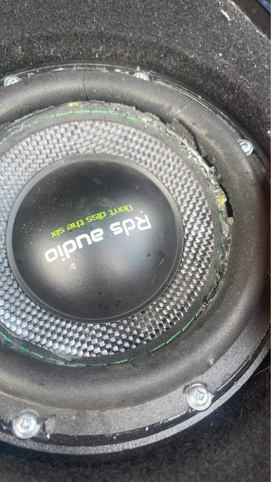

We have a guy in my city that hit something like 147 DB with 6.5s. Super impressive but its made to play just that tiny range of higher frequencies. A week later I had numerous kids message me wanting boxes for 6.5s, and showing me this video of a guy hitting 147 DB. Only 1 person actually knew what he was getting (older guy who likes rock and country music). The other guys, I had to try to talk out of getting 6.5s after finding out they listen to rebassed and rap music. I had blown 6.5s sitting everywhere from these kids trying to hammer lows with 6.5s in a ported box. Then this happens……
That’s a super nice 6.5 btw. Best on the market in my opinion, but they have limits and need a subsonic filter In a ported box, especially if your music habit is to play content with clipped sine tones under port tuning.

Those Rds 6.5's are capable. People constantly try to throw a strong 3K or more at them then play under 30hz content full bore resulting in what you pictured above. They even overpower the ssf setting sometimes... no joke. Any idea where the box was supposed to be tuned in that photo? I've done multiple designs for those subs and they'll perform but they do have limits. I cringe when hearing someone wants those subs on a big (3K+) amplifier. Dollars to donuts they'll be trying to play content under 30hz boosted by an epicenter. I try to design around preferred music and hard usage but there's only so much you can do. Here's an example...
Tuned 36hz playing under 30hz with big power is a recipe for failure, and Its always the enclosure's fault. Its the 1st place everyone points their finger when subs die. "User error" is alive and well just as its always been... :LOL:
