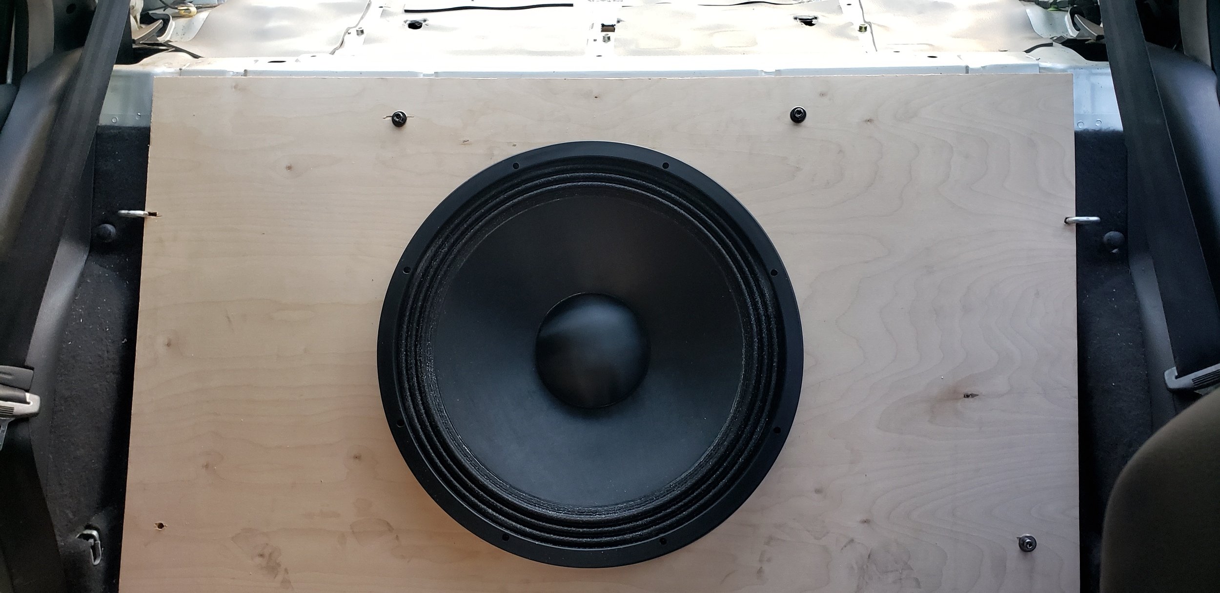

I personally would just run two car audio 15s ported. Most pro audio 21" drivers are more designed towards mid bass and not sub bass. Plus they usually come in single 8 or 4 ohm configuration. I have seen a 4 18 pro audio wall a long time ago down here in Florida and it was very impressive but didn't really play low.
Most of the PRV demo vehicles at all the shows run them for their stunt walls. If you aren't concerned with playing under 40hz go for it. Would be different for sure.
This is the FR of the PRV 18" As you can see it drops off pretty quickly at low frequencies.

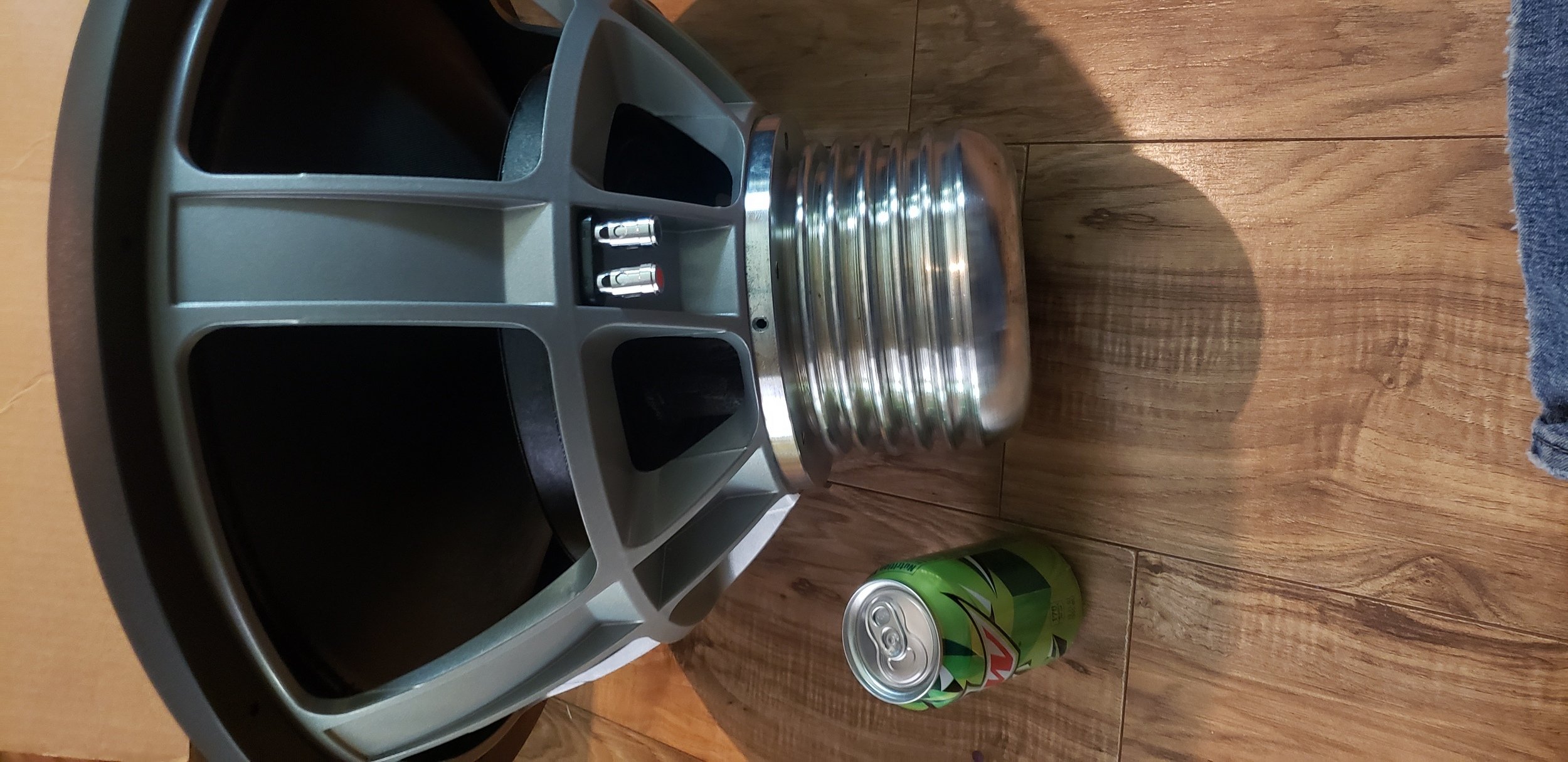

I've had a 21", I've heard them. IA makes a really good 21". Does Fi make a Neo 21"? The Warden 21" was a f*cking beast.
