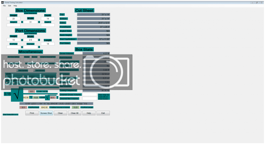

Before I start dropping hundos
Heres how my box looks now (please disregard wiring, I plan on cleaning it up)
Heres what I came up with in the torres calculator.
I got it close to 4cf. Its around 30hz. I wanted to run chambered but I don't have enough space. I had to make the box taller (about 3-4in) and about 1 in wider and 1 in deeper.
This is what I'm looking at however it will be facing up.. (I got this from the torres calculator)
Any comments or concerns? Thanks for your help.
