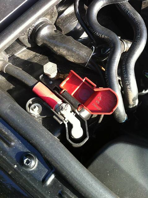

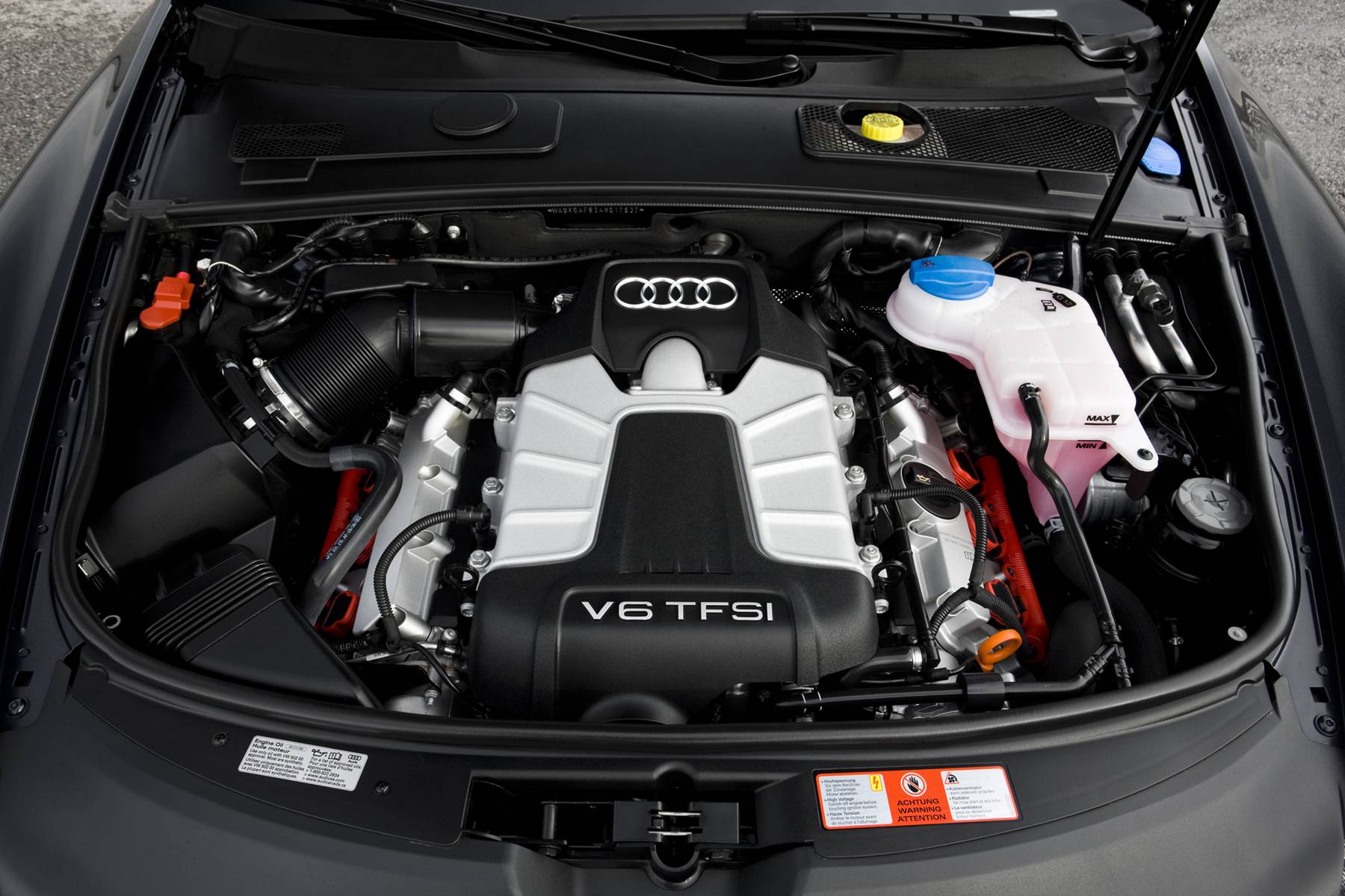

you could use Audi A6 parts. they have a remote jump start under the hood.
Its the red thing in the top left corner of the picture

Thanks for the input, I think I will just go with the Anderson plugs, I understand what everyones saying about the bolt, I just wanted something that looked nice. I know alot of cars (such as that Audi //content.invisioncic.com/y282845/emoticons/yumyum.gif.0556df42231b304b9c995aefd13928a8.gif) has factory jump points, maybe Il check a junkyard and see what I can find
