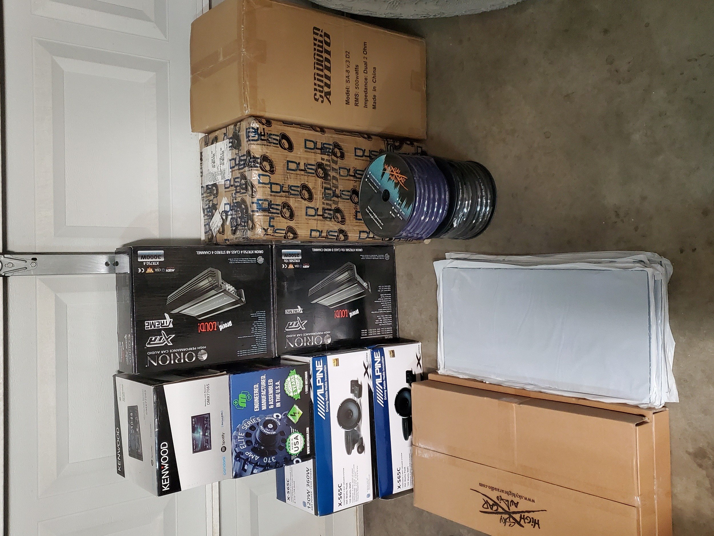

Hi new to forum, have had a lot of stereos over the years in cars and boats. I have never ran lithium before currently have 4 optimas bluetops in the boat. Have a new system going in truck and would like options... 2013 duramax crewcab, stock 2 batts up front, will be running orion xtr 2500.1 to 4 sundown sa8s, and orion xtr.750.4 to alpine x componets .. mechman 370 alt. I think my underhood temps especially while towing would way exceed what a underhood lithium could take can i keep my 2 starting batts and add a lithium and isolate? One big lithium? I see the xs titan 8s look impressive. I want to be able to run stereo HARD with truck idling... what would you guys do or reccomend?
