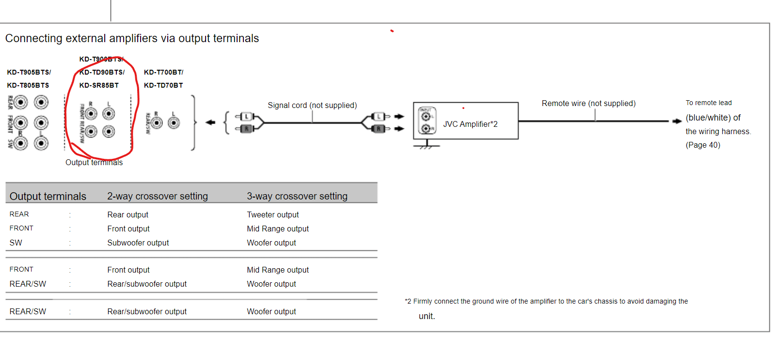

i have front,rear,left,right rca plugs
Have to use a set of rca splitters then and I would split the fronts so they are used for the front & rears at the same time so the rear rca's are used for the subwoofers since they can be controlled from there. Something like that below or w/e brand you want to use
Then just run the Front outputs to the 4-channel, and the Rear/SW to the mono. You should be able to run one remote wire and splice it into both amps for the turn-on. And since you'll be running two power cables you may see a drop in voltage and dimming lights... then you may need to upgrade your electrical (i.e., big 3, alternator, battery).
