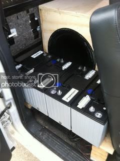

what deka? thats a killer deal..
Its an unlabeled Deka gel cell UPS battery, 70 ah .... I've got 6 of them running in my jeep now. I thought I could fit it under the hood but that didn't work out too well, so this is just an extra. Yeah I know i'm giving it away, just need it out of the way at the shop.
