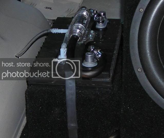

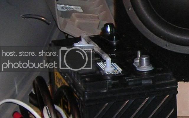

Otherwise you can vent straight to the vent caps like I did. I haven't found the time to post a build log yet but heres a few pics.
Wow, that is awesome. Should those maxx marine batteries have those vent tubes on them? I have a port hole thing that I already run my power wire through, so that would be easy.
Where did you get the supplies for that?

The tubes/fittings are from home depot and ace hardware. If you look closely at the vent caps on these batts, you will see 1 small vent on the side of each cap. It would not be easy to connect a tube to that small vent, so I just plugged it up and drilled my own 'vent'.
I just removed the caps, drilled holes on the tops, used loctite super glue gel to hold everything together. I also used loctite/silicone to plug the 1 vent on each cap. Then I used clear silicone just to double check that everything was air tight. I then installed the caps with the new fittings. Finally I attached everything and drilled a hole through my side panels to vent outside at the rear tire well.
I know the pvc fittings and tube will be fine with the acid fumes, but I'm not sure how the glue and silicone will hold up over time. I plan on checking it every few months just to make sure everything is ok.
It would be much easier to make/buy a box, but my space was very limited. If you try this its not hard, but you have to be very careful when messing with the battery vent caps!
The caps are the actual caps that can be removed to the acid resevoirs? Haven't really looked at batteries that closely...
Ya, they can be 'carefully' removed with a flat head screwdriver. Then when you replace them you need a rubber mallet (or I used a hammer and a piece of mdf) to snap them back in.
I rinsed the caps thoroughly in water and let them air dry over night to make sure I wouldn't touch any acid. Also I made sure the open holes were covered well so no dust/etc would fall in to the acid.
