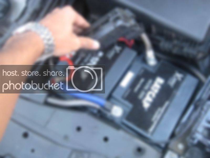

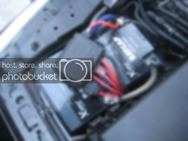

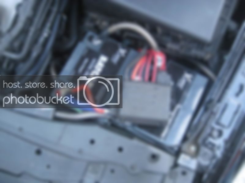

this nikka is riding GQ, 2 under. dont ask how we managed to fit em
looks good to me bud but i think you should do the big 3..
He has no need to do the Big3. look at how much power he has total just for the amp. only 700ish watts. That is not a lot of power, especially for a VW(their altys are big to start with). I could run the same amp on a stock Honda alty and a stock die hard battery.
heck even that 2nd battery wasnt necessary, but shit it looks baadass under there, I wonder what the dealer would say lol.
